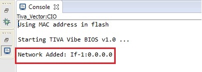

When I set any IP address(e.g. "0.0.0.1") except of "0.0.0.0" I get:
and my device send UDP packets to network.
But if I set "0.0.0.0", I get:
and my device doesn't send any packets.

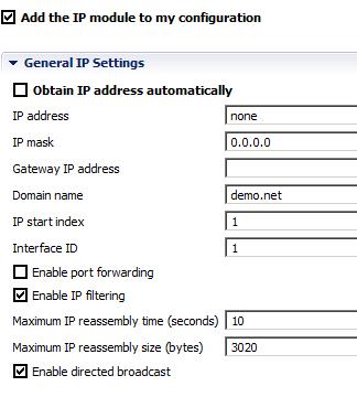

    One option may be to not assign _any_ IP address to the device. You can do this by setting the IP address to be "none" in your configuration file.
    So, in this case your app won't run as a DHCP client (the NDK's DHCP client), and so won't try to obtain the IP address from a DHCP server in the "normal way."
    You could instead run the code to get the IP address from your customized DHCP server, however you might do it, and then once you have an IP address offer, you could add it as a static IP address on the device.

    I tried to, as you advised, set "none" as IP address:
    Unfortunately, in this case the Tiva doesn't send any message.
    If I marked the box "Obtain IP address automatically", the Tiva only  send the standard DHCP message from 0.0.0.0 address , but not any others  messages.
    If I set any others IP addresses(except of 0.0.0.0) e.g. 0.0.0.1 the Tiva starts to send our message.

    We made changing in function NtAddNetwork()
     if( !IPTrialAddress )
    /* Destroy the binding with the bad IP address */
    ;//BindFree( hBind );
    //hBind = 0;
    and rebuild NDK. After that, when SW start in debug mode, we see the message on the "Console" window "Network Added: If-1: 0.0.0.0" which was not before changing
    but unfortunately the TIVA still not sending any Ethernet message. Possibly there is else others checks in NDK.
