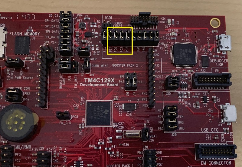

To start, you will want to remove the JTAG jumpers from your DK-TM4C129X board:
This will remove the connection to one ICDI device, and that should help with the confusion of the Programming Tools.

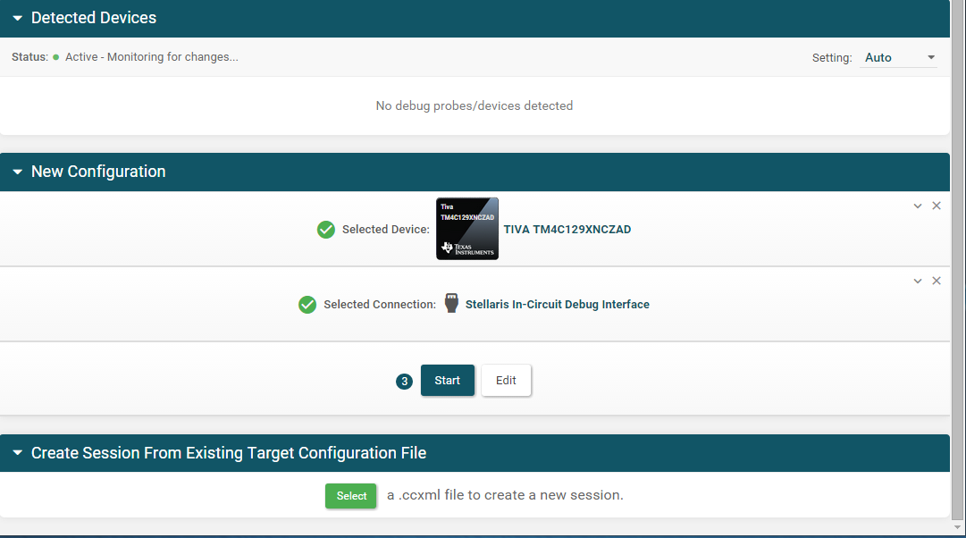

After this, go ahead and load up CCS Uniflash, Select your Target Device as the TM4C129XNCZAD, and Select the Stellaris ICDI. Then Start the Connection:
This should then start up the board properly without the above reported errors. With the connection properly established, now put the JTAG jumpers back on to connect JTAG.
With JTAG connected and the right ICDI started, you should be able to successfully run a Flash Erase in the Settings & Utilities tab to clear your mis-programmed device and restore typical operation:
