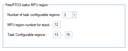

We are trying to use DMA with activated cache on a TMS570LC4357, within a FreeRTOS project. We configured a non-cachable region (region 15) at the end of RAM as explained in https://www.hackster.io/jancumps/hercules-configure-memory-cache-for-dma-0945cd, which is based on a solution coming from the TI forum. However the variables allocated in region 15 still seem to land in the cache, as the DMA sends empty data. If cache is deactivated, it works as expected.
In HalCoGen, in the MPU tab, there is a setting for FreeRTOS:
It looks like FreeRTOS always configures region 15. In the file os_portasm.asm generated by HalCoGen, the following code is found:

  • FreeROS overrides any MPU configuration done prior to starting the OS. Refer to this application note for more information on how to manage MPU settings when using FreeRTOS. The relevant info is in appendix A.
  • The MPU settings are configured in vPortStoreTaskMPUSettings(). The note before the function says
    „/* Note: By default, all the RAM regions are configured to be cached (write-back, write-through) for better performance.
       This configuration is not suited in case multiple bus masters access the RAM, for example, DMA or EMAC master.
       Please use the USERCODE section below to change the default MPU settings */“
    So we defined the non-cachable section in the user section at the end of the function, with the code
    xMPUSettings->xRegion[portNUM_CONFIGURABLE_REGIONS-1].ulRegionBaseAddress = 0x0807F000;
    xMPUSettings->xRegion[portNUM_CONFIGURABLE_REGIONS-1].ulRegionSize        = portMPU_SIZE_4KB | portMPU_REGION_ENABLE;
    xMPUSettings->xRegion[portNUM_CONFIGURABLE_REGIONS-1].ulRegionAttribute   = portMPU_PRIV_RW_USER_RW_NOEXEC | portMPU_NORMAL_OINC_SHARED;
    The index (portNUM_CONFIGURABLE_REGIONS-1) is used because we want to use the last configurable region. With this configuraiton, the non-cachable region works as expected.
