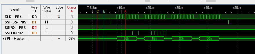

CCS/TM4C123GH6PM: SSI2 SG causing uDMA bus error.
Part Number: TM4C123GH6PM
Other Parts Discussed in Thread: EK-TM4C123GXL
For some reason this is causing a bus error.

#define NUM_SG 4
#pragma DATA_ALIGN(sg_tx_list, 16)
tDMAControlTable
sg_tx_list[NUM_SG] = {
    uDMATaskStructEntry(
        1024,
        UDMA_SIZE_8,
        UDMA_DST_INC_8, &(g_ui32SrcBuf[0]),
        UDMA_DST_INC_NONE, (void*)(SSI2_BASE + SSI_O_DR),
        UDMA_ARB_1,
        UDMA_MODE_BASIC),
#pragma DATA_ALIGN(sg_rx_list, 16)
tDMAControlTable
sg_rx_list[NUM_SG] = {
        1024,
        UDMA_SIZE_8,
        UDMA_SRC_INC_NONE, (uintptr_t)(SSI2_BASE + SSI_O_DR),
        UDMA_ARB_1,
        UDMA_MODE_BASIC),
// Initializes the uDMA software channel to perform a memory to memory uDMA
// transfer.
void
DispatchSSITransfer(void)
    uint_fast16_t ui16Idx;
    // Fill the source memory buffer with a simple incrementing pattern.
    for(ui16Idx = 0; ui16Idx < MEM_BUFFER_SIZE; ui16Idx++)
        g_ui32SrcBuf[ui16Idx] = ui16Idx;
        g_ui32DstBuf[ui16Idx] = MEM_BUFFER_SIZE - ui16Idx;
    // Enable interrupts from the uDMA software channel.
    ROM_IntEnable(INT_UDMA);
    MAP_SSIDisable(SSI2_BASE);
    MAP_SSIConfigSetExpClk(SSI2_BASE,
                           ROM_SysCtlClockGet(),
                           SSI_FRF_NMW,
                           SSI_MODE_MASTER,
                           ROM_SysCtlClockGet()>>4,
                           8);
    MAP_uDMAChannelDisable(UDMA_CH12_SSI2RX);
    MAP_uDMAChannelDisable(UDMA_CH13_SSI2TX);
    MAP_uDMAChannelAttributeDisable(UDMA_CH12_SSI2RX, UDMA_ATTR_ALL);
    MAP_uDMAChannelAttributeDisable(UDMA_CH13_SSI2TX, UDMA_ATTR_ALL);
    ROM_uDMAChannelScatterGatherSet(
            UDMA_CH12_SSI2RX,
            1, &(sg_rx_list[0]),
            1);
            UDMA_CH13_SSI2TX,
            1, &(sg_tx_list[0]),
            1);
    MAP_SSIIntDisable(SSI2_BASE, 0xFF);
    //MAP_SSIIntEnable(SSI2_BASE, SSI_DMATX);
    MAP_uDMAChannelAssign(UDMA_CH12_SSI2RX);
    MAP_uDMAChannelAssign(UDMA_CH13_SSI2TX);
    MAP_SSIDMAEnable(SSI2_BASE, SSI_DMA_TX);
    //MAP_IntEnable(INT_SSI2);
    MAP_SSIEnable(SSI2_BASE);
    //MAP_uDMAChannelEnable(UDMA_CH12_SSI2RX);
    MAP_uDMAChannelEnable(UDMA_CH13_SSI2TX);

  • Your code did not make much sense to me. I went ahead and wrote an example using uDMA to send and receive on SSI2. It uses basic mode for the transmit and ping-pong mode for the receive. One trick is that for SSI2 you must use a secondary uDMA channel so you need the calls to uDMAChannelAssign().
    Here is a logic analyzer picture of the transfers:
    Use the Code Composer "File"->"Import" function to add the project in the .zip file to your workspace.
    /cfs-file/__key/communityserver-discussions-components-files/908/udma_5F00_demo_5F00_SSI.zip

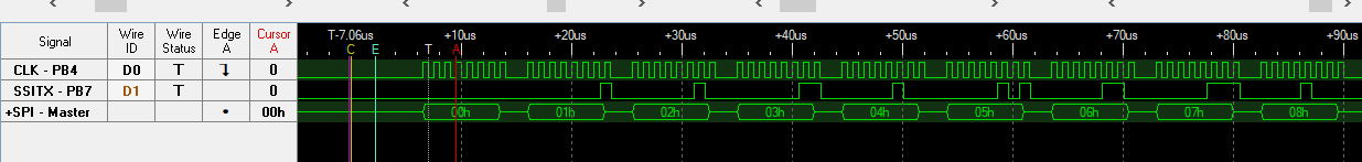

  • Sorry, this took me longer than expected. I have attached a simple example that uses uDMA and SSI(SPI) to read a serial EEPROM. The uDMA is in basic mode to write the SPI. It writes a command, an address and then two dummy bytes to generate clocks for reading the results. The uDMA is in Scatter/Gather mode to read the results. The first uDMA task reads the first two bytes, which are dummy bytes, and discards them. The second uDMA task reads the next two bytes and stores them in a 16-bit variable. Since the serial EEPROM requires that the chip select stay low during the entire transaction, it is emulated with GPIO. It is set low as the uDMA is started and set high in an interrupt routine after the last byte is received.
    Here is a logic analyzer picture of the results. (There was no serial EEPROM attached so the data returned is 0x0000.
    /cfs-file/__key/communityserver-discussions-components-files/908/udma_5F00_demo_5F00_SSI_5F00_SG.zip
  • Bob,
    Rock and roll! This works. I was able to change it to use SG for both transmit and receive and verified with a loopback jumper. Now with a clean working state I can fix whatever is broken with the driver! Thanks a ton! This should totally be included in an example package or something to demonstrate SG to SSI.
