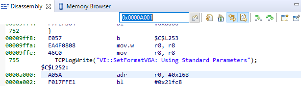

The link register on the stack (0x0000A001), does point to actual code (shown in the image below).  However, as far as I can tell, the code in the TCPLogWrite function is harmless.

  2. Is it safe to say the issue is likely happening in the TCPLogWrite function or might the LR be a red herring?

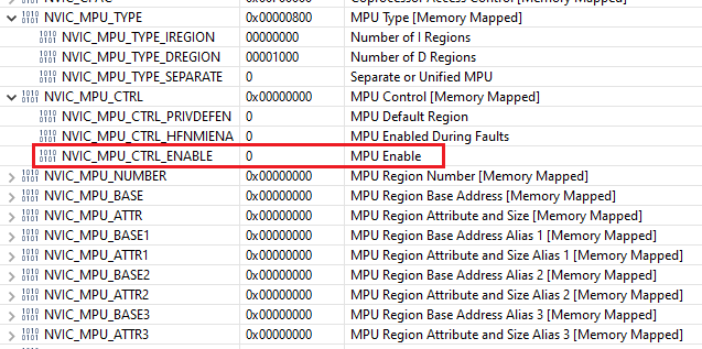

    Hi Bob - Thanks for the reply.  I do not have experience with the MPU.  Looking at the MPUCTRL register, it appears it's disabled:
