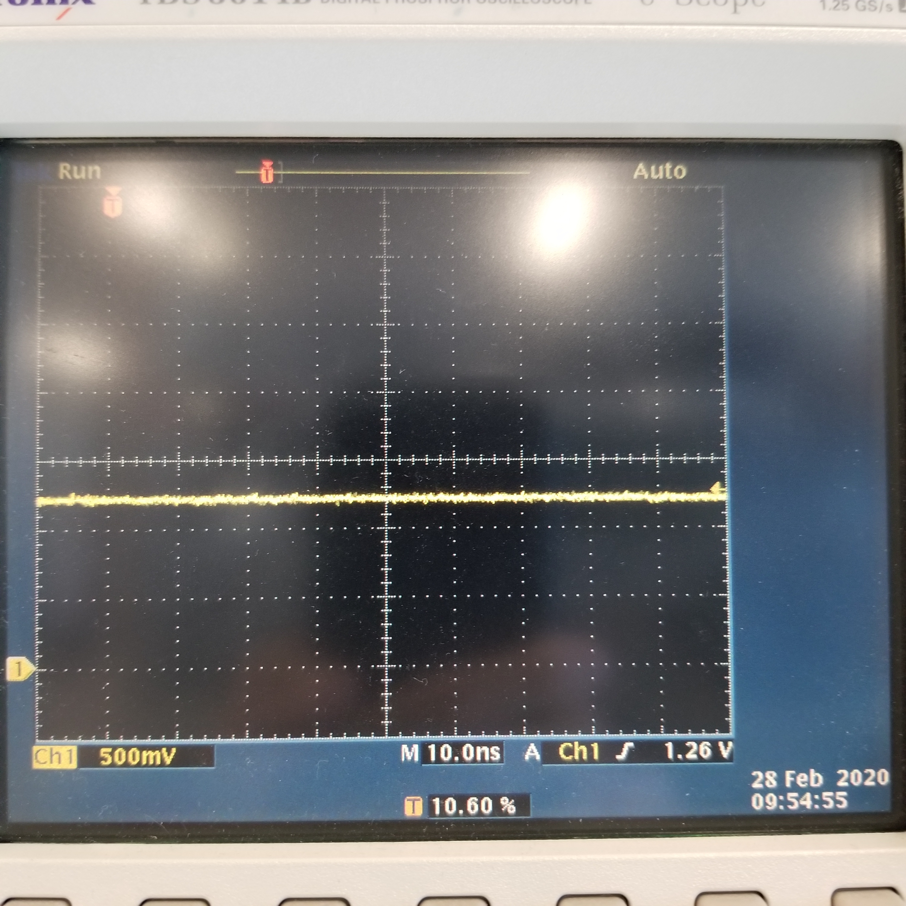

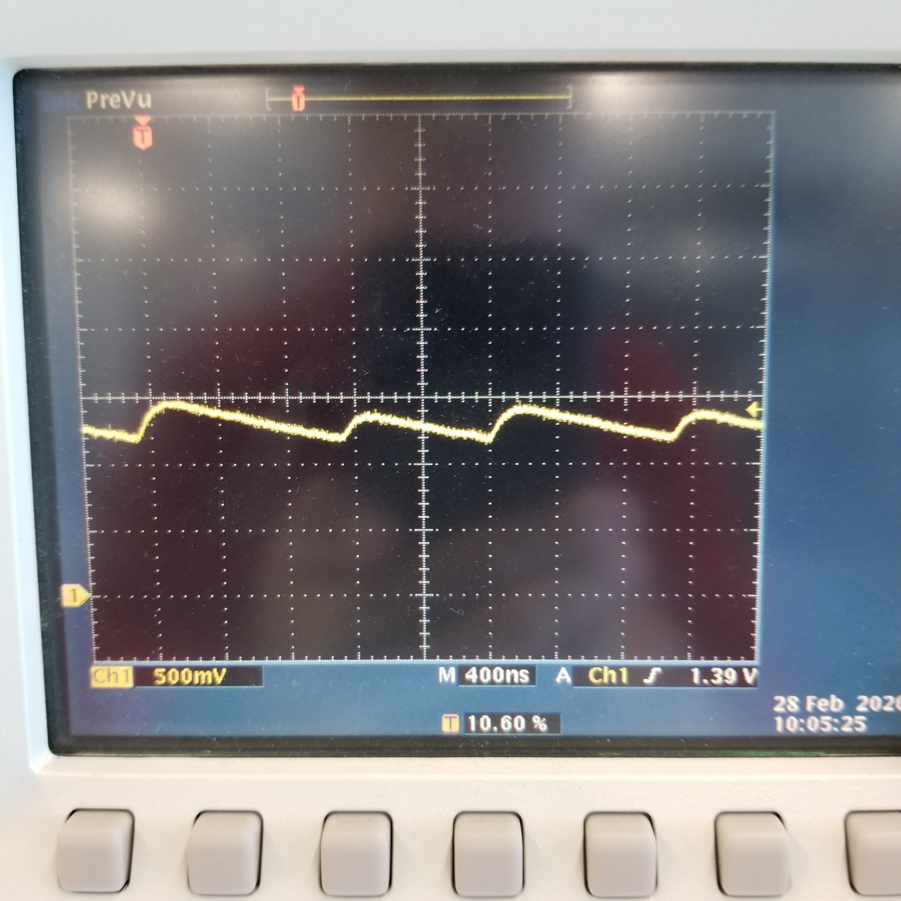

  • As you requested, I took an EK-TM4C123GXL Launchpad and removed the four filter capacitors on the LDO, C10, C11, C12 and C22. The board continued to operate and run code with the capacitors removed, but the core 1.2V showed a sawtooth waveform. Pictures of the core voltage with and without the capacitors is shown below. Bottom line, the part was not damaged.
    Normal with filter caps:
    Without filter capacitors:
