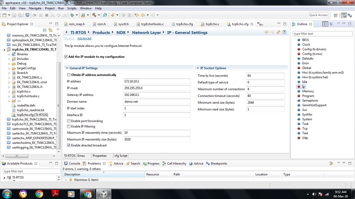

Hello ,
I am working on a project using Tiva, TM4C1294NCPDT MCU ON TIRTOS environment and uses NDK module for TCP client application. My application use static ip connection and I am enter this address in to .cfg file. tcp-echo application is works fine with any ip address entered on .cfg files.
But I want to change ip to be enter in run time. I am already done with following which was posted on one of your portal and tried but it is not connected with new ip. .
  1. use the NDK hook "Network open hook" instead of "Stack begin hook" for 'readIPAddr()'
  2. find and remove the static IP address that's initially added (unbind it from the interface)
  3. add the new IP address (bind a new one)
Here's the updated code I used to do this (covers steps 2 + 3 above).  You can change it to read and use the IP address in ROM:
    CI_IPNET NA;
    HANDLE      hCfgIpAddr;
    /* Setup manual IP address */
    bzero(&NA, sizeof(NA));
    NA.IPAddr  = inet_addr("172.16.10.2");
    NA.IPMask  = inet_addr("255.255.255.0");
    strcpy(NA.Domain, "demo.net");
    NA.NetType = 0;
    /* get the current static IP entry */
    CfgGetEntry(0, CFGTAG_IPNET, 1, 1, &hCfgIpAddr);
    /* remove the current static IP entry */
    CfgRemoveEntry(0, hCfgIpAddr);
    /* add a new static IP entry */
    CfgAddEntry(0, CFGTAG_IPNET, 1, 0,
            sizeof(CI_IPNET), (UINT8 *)&NA, 0);
I have added above routine on netOpenHook function(tcp-eco sample code) which is already Network open hook function.
On console following is displayed where 172.16.10.1 is .cfg ip address and 172.16.10.2 is new ip.
Network Added: If-1:172.16.10.1
Network Removed: If-1:172.16.10.1
Network Added: If-1:172.16.10.2
Strange behavior is this new ip is getting ping on cmd prompt but when is connected to hyper terminal is it not connected. The accept function is not return the connection. Why is it so? When this above routin is comment form netOpenHook function , it is connected to .cfg ip address(i.e 172.16.10.1)
  • Hi Anushka,
    I want to clarify some things. Your target device has an IP that you manually assign in the .cfg file. You want to assign a different static IP address at run-time.
    1. What do you mean by "when is connected to hyper terminal it is not connected"? Are you using hyper terminal to run the tcpSendReceive application?
    2. Which accept call is failing? Is it the call inside tcpHandler in tcpEcho.c?
      1. If so, when using the *.cfg static IP address, are you saying that your tcpHandler accept call succeeds and you can successfully echo messages back and forth between your PC and the target?
    Brandon
  • 1) What do you mean by "when is connected to hyper terminal it is not connected"? Are you using hyper terminal to run the tcpSendReceive application?
    yes we are using hyper terminal as tcpsendreceiver application. the connection is not establish between client and server when ip is changed at run time.
    2) Which accept call is failing? Is it the call inside tcpHandler in tcpEcho.c
    yes tcpHandler in tcpecho.c.
    whenever try to connect with new ip this accept function is accept the connection and return the connection id as clientfd . this will not return anything whenever ip is changed in run time.
    i have attached tcpEcho.c and tcpechohooks.c files. i just want to change ip at run time. my application is used static client base application where as pc is server.(as we are connected to hyper terminal).
        NA.NetType = 0;

  • Hi Anushka,
    Thanks for providing your code. Have you tried using other IP addresses at run-time?
    I do not run into any issues as long as I choose an IP that is within my network. i.e. 192.x.x.x works for me, while 172.x.x.x does not.
    You may want to check your network configuration to see what IP addresses fall within your network.
    What is odd is that you said you can ping the IP after assigning it to the device at run-time, but you cannot echo messages back and forth. The next step would be to start debugging from the accept call to see precisely where the program is failing.
    Brandon
