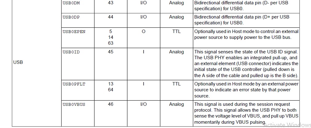

Part Number: TM4C123GE6PM
I have a USB link up and running with the USB stack (USB ware) as a HID device. I'm seeing that when I plug the USB cable in I get a "USB_EVENT_CONNECTED" event that fires in the ISR. This is great. The problem I see next is upon unplugging the cable. When I unplug the cable I do not get a "USB_EVENT_DISCONNECTED". Instead the "USB_EVENT_DISCONNECTED" fires when I plug the cable back in.
So my sequence of ISR events are basically as follows, upon plugging in a USB cable I get a "USB_EVENT_DISCONNECTED" event first then a "USB_EVENT_CONNECTED". This is an issue because my firmware needs to know when the USB link is plugged in / connected.

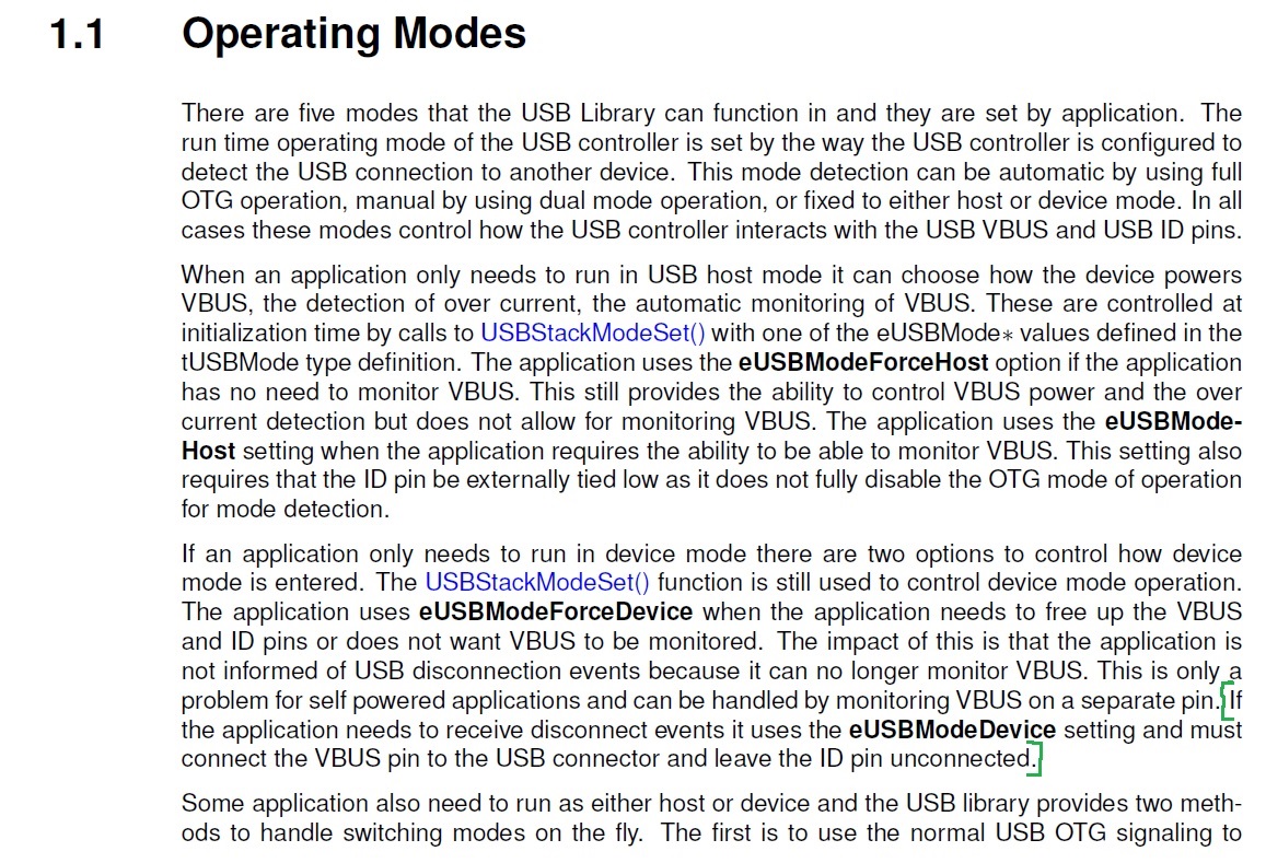

// Set the USB stack mode to Device mode with VBUS monitoring.
USBStackModeSet(0, eUSBModeForceDevice, 0);

Is there some configuration in the driver that you have to enable to detec plugging and unplugging properly? I'm surprised by this behavior. Any help is greatly appreciated!
