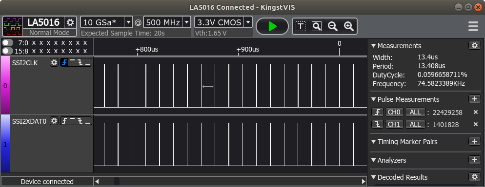

Greetings! I'm using TivaC with TFT 2.8 SPI Module ili9341 (http://www.lcdwiki.com/2.8inch_SPI_Module_ILI9341_SKU:MSP2807). And i have a problem: too slow refreshing of screen (0.6 FPS). I figured out what problem is slow SPI connection. After this i checked it out with oscillograph (Real speed is 45.45 KHz but i configured TivaC SPI as 10 MHz).

    4) Ye, i did. Same thing. Unstead of 60 MHz i get 71.42 KHz
    I attached a little bit changed TI SPI example. I removed slave task and create a SPI flooder in master task. SPI bitrate 60 MHz (1/2 of Clock). Oscilloscope is showing 1 pulse per 14 uSec i.e. 71.42 KHz

  • Georgy Tuzikov said:
    I attached a little bit changed TI SPI example. I removed slave task and create a SPI flooder in master task. SPI bitrate 60 MHz (1/2 of Clock). Oscilloscope is showing 1 pulse per 14 uSec i.e. 71.42 KHz 3568.spiloopback_EK_TM4C1294XL_TI_TivaTM4C1294NCPDT.rar
    What time base is your Oscilloscope set to?

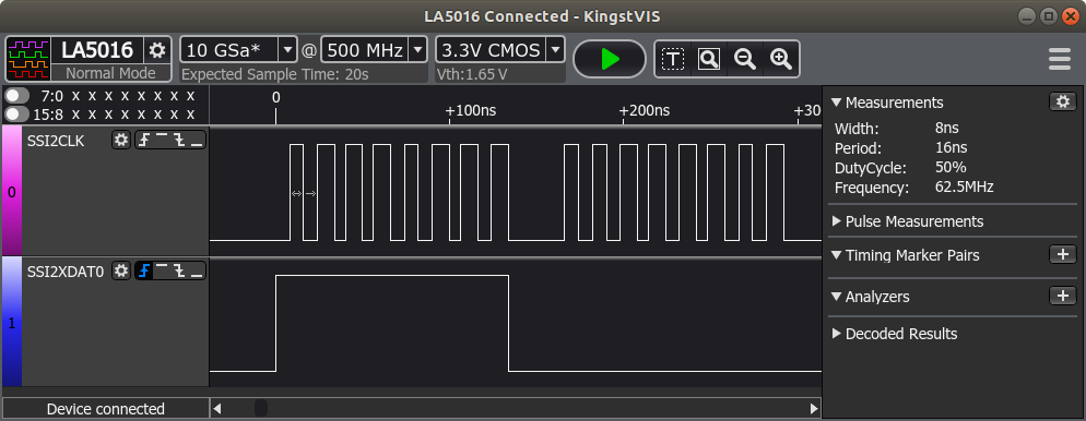

    I took the example and ran it on a EK-TM4C1294XL on a LSA set to 500 MHz sampling rate, connected to SSI2CLK and SSI2XDAT0.
    With a low zoom at first sight the SSI clock pulses appear around 13.4 uSec apart:
    However, when zoom in then the SPI clock is shown as nominally 60 MHz:
    I.e. suspect that your Oscilloscope "showing 1 pulse per 14 uSec" measurement is not the SPI clock rate, but rather the rate at which the following software loop in the code is running at:

  • Hi Chester, thanks for the reply.
    Ok, i got it. My bad is what i counted not SCK pulses...
    So, i checked again - same as you checked i.e. ~60 MHz on SCK wire.
    If i configure SPI as 60 MHz i'll get 7.5 M bytes per second i.e 48 FPS. And i'm stumped because of this.
