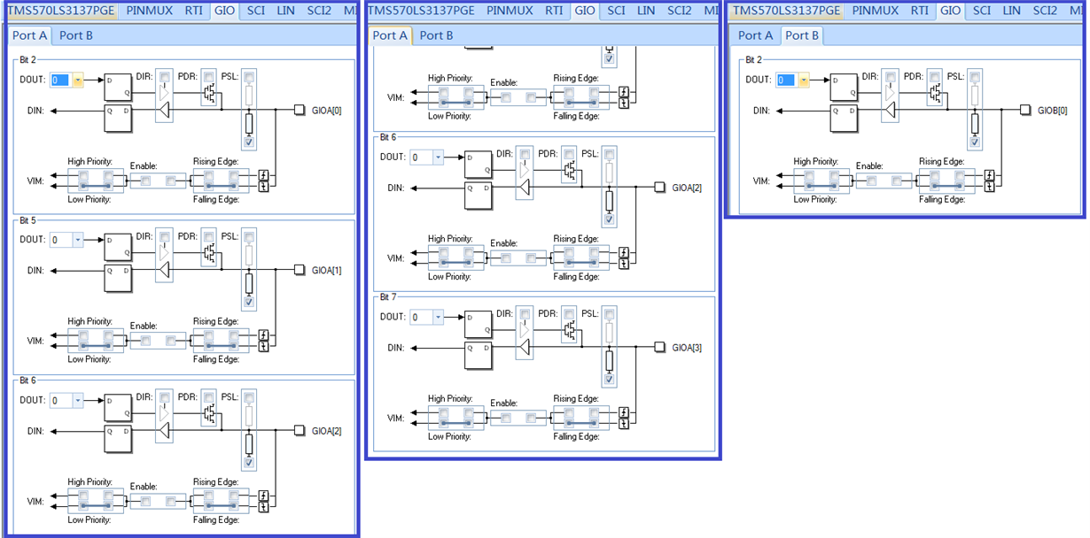

I'm verifying the prototype of my design. I selected TMS570LS3137PGE and purchased a TMS570LS12x LaunchPad. It is very impressive for me to use HALCoGen to config peripherals and generate codes.
However I found there are 4 bits of 2/5/6/7 for GIO port A and bit 2 for port B, as below. Does it mean I have at most 5 pins of 9/14/16/22/55 being used as GIO for lighting a LED or accessing address pins and EN pin of multiplexer such as DG408 etc ? Is there any way to make other unused IOs such as FlexRay work as GIO ?
regards
Datïan
    For TMS570LS12x PGE package, there are only 5 GPIO pins (4 GIOA, and 1 GIOB). You can use N2HET pins, MibSPI pins as GIO, Flexray pins can not be used as GIO.
