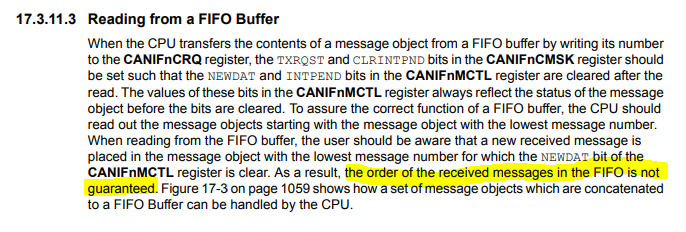

  • First, let me point out, as stated in the datasheet, when using FIFO mode the order of received messages is not guaranteed. If this is important, then I suggest instead you use a single message buffer and a high priority interrupt to read the message buffer into a software FIFO.

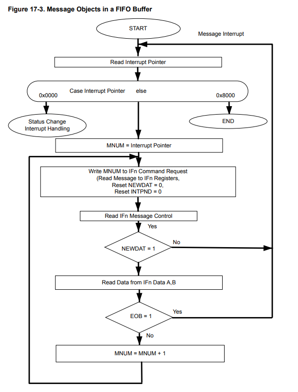

  • To read the message objects from a FIFO buffer you should follow the flow chart given on page 1059 of the datasheet.
  • I´m aware about the order of the received messages and its not a problem for my project, but my doubt its about where the data is stored after the CANMessageGet function beacuse in the example the sMsgObjectTx.pucMsgData its not set, like it is for transmit "sMsgObjectTx.pucMsgData = pui8BufferOut;" so its the explample missing that step?
  • Sorry, I just looked at that example in section 6.4 of the Driver Library User's Guide. There are several issues with that example. I need to take some time to correct it and then I will post a better example. To be more specific, the function CANMessageGet() will only read the data received in one of the message objects. When using FIFO mode, you must cycle through the message objects that are part of the FIFO and read each one that has new data in it. The example code clearly does not do that.
