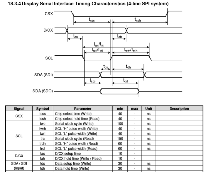

Problem is what LCD is filling up in 1.6 secs. i.e. i've got 0.6 FPS. I don't know what's wrong (But SPI is fine, it's really configurated 60 MHz. I checked this out by my oscilloscope).
Problem exactly in my code because of some guys reached 10+ FPS on this displays on Ard*ino (Proof: https://www.youtube.com/watch?v=WapdjBnF7tQ&t=0s)
I'm stumped with this problem. Please, help me...

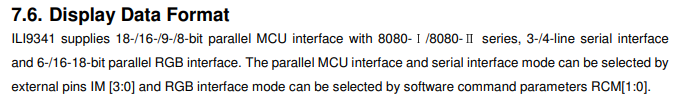

    • adopting the TFT's "SPI mode" which best enables the (potential) "Reduction in number of Transmissions" & "other MCU outputs?"
    • properly complying w/the Display's Timing Specifications?    (You are in significant violation - may or may not impact update speed - yet never good!)
    • use of the RTOS - especially when you should strive, "To reduce the number of (potential) delaying and complicating factors in play" is a clear violation of "KISS!"    As earlier noted - initially bypassing the RTOS simplifies & eases your investigation!    And by discovering the performance level achieved "without the RTOS" - you are able to (later) clearly note (any/all) penalties the RTOS is likely (i.e. surely)  to impose...
    • and carefully/critically observing all, "Inter-Character" delays (i.e. between each SPI char. or word transfer) to see "If & How" these may be reduced.
    Let's deal w/each in (the easiest) reverse sequence.    The ILI9341 spec notes:
    Your selection of a "60MHz" SPI clock (SCL) - yielding ~16nS (total pulse width) - grossly undercuts the (40 + 40) 80nS (total) - as spec directed above.    Spec violation is unwise - and while this may "not" be the (entire) cause of your slowed update - it is to be avoided!    (And may indicate a, "Lack of Attention to Detail" - which may lead to (other) spec violations & errant conclusions...)
    SPI Mode: We cannot tell which of the two SPI Modes - offered by the Display - was chosen.   This demands your "configuring" of 4 "IM bits."   We believe that the "4 bit SPI Mode" offered - as shown below - best enables your data transfer via, "16 bits."    Such "wider data transfer" most always increases Update Rate.

    About SPI speed:
    I checked on stm32, raspberry pi and arduino forums SPI speed for this LCD. 60 MHz is good, even if it is not wrote in datasheet.

  • Not that anyone cares here - yet the "Screen Update Speed has improved" due to the, "Reduction in "Inter-Character Delays" - which is achieved by "Increasing the Number of Bytes (or Words) w/in each SPI Transaction."    Such could have been "Far more quickly/easily noted" had the (much earlier) suggestion been followed...   As the MCU's SPI clock rate has continued (unchanged) it is "only" that the reduction in (unwanted) Delay Duration (i.e. "Inter-Character Delay") has occurred!    (that delay is imposed 76,800 times - thus the "Improvement Potential" may prove "massive!")    And was (easily) predicted...
    Above found w/in the post of 8 Mar @ 22:50 - 6th Bullet Point w/in the (detailed) list.   And again - so seriously Violating the Device's  (SCL) Spec - opens the door WIDE to "Future & On-Going HORRORS!"   (which will arise "long after" the Spec Violation has been forgotten...)
    Review of the ILI9341 manual appears, "Not to support" the 16 bit, Serial (SPI) Transaction.
    As noted (several times now) some attention to (and compliance with) the "Targeted Device's Data-Sheet" (and spec) IS required!
  • cb1_mobile,
    if you know how to reduce Inter-Character delays, tell me, please. I'm all ears
  • Has that point not (already) been made clear?    Increasing the number of SPI Transactions w/in the SPI Data Frame has the "welcomed" side effect - of substantially reducing "Inter-Character" AND (likely) other SPI Format Delays...
    Had you scoped the SPI Transactions - "keying upon any/all (Inter-Character (or other) delays (spacings)" - this would have notably revealed...
    You may benefit by noting that, "Sending (only) a single color to the Display" is vastly different (far easier) than when you are tasked to (both) process, fetch, & present "REAL" (meaningful) Data to the Display!   It is during this far more "Real & demanding effort" - that your program's "weaknesses" will (unhappily) reveal...   (And necessarily - drive down your Update Rate...)

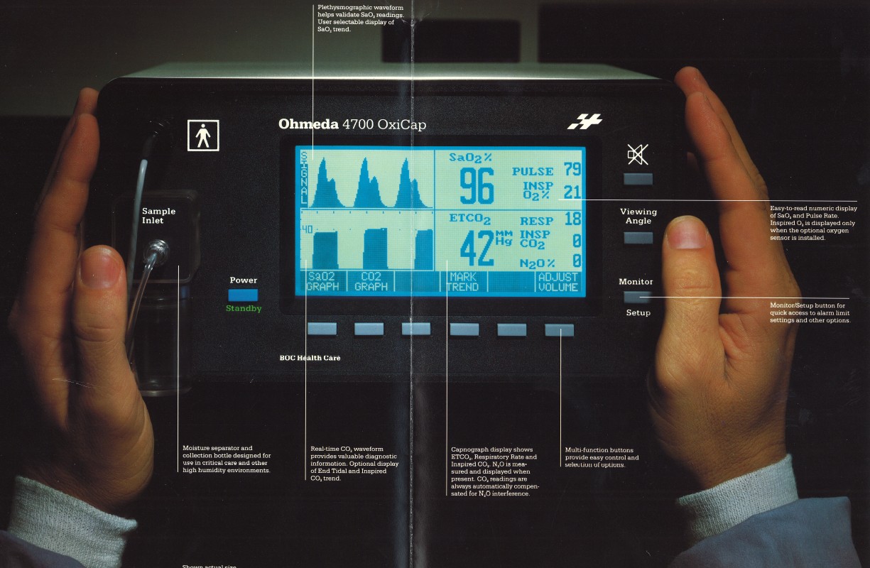

    Shown below is a "Blood Oximeter" - produced by a past firm I co-founded - and which saved literally, "Thousands of Lives!"   The U.S. "FDA" has extremely strict Tech. "Rules & Regulations" - and (Never) did my group: Violate Technical Specifications and/or accept "Tech Guidance" from (random) "youtubers!"    The LCD shown had demanding "Update Rates" - and many of the techniques I "Shared w/you" - enabled the significant success this medical device enjoyed...
    You & others - adopting the more "Methodical & Systematic Techniques" we've presented - may in time realize (similar) rewards...   (both life-saving & financial...)
  • You probably don't understand at all that to do something complicated, you need to start with something simple? Simple-color output, complex - output of useful data. To output useful data, I must first achieve normal FPS, which I do by sending a single color.
    The fact that you saved a lot of lives with your device is great, my respect, but it's not nice to tease a person about the issues they face, at least.
