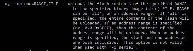

  • Marcin Okarma said:
    What exactly does errorlevel 0xC000 0005 stand for?
    That is the Windows error for an Access Violation.
    If I attach the Microsoft Visual Studio debugger to the lmflash program, the the Microsoft Visual Studio debugger reports an access violation at the point the "Uploading.." percentage progress stops when trying to upload more than 512KB:
    After this access violation, Windows terminates lmflash.
    Without the source code not sure what the problem is, but maybe the cli mode only allocates a 512KB buffer for storing the flash content leading to an access violation when attempts to store off the end of the buffer.
