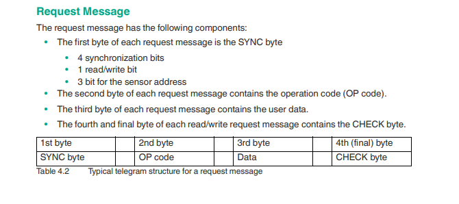

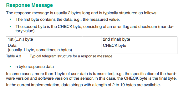

hello everyone ,

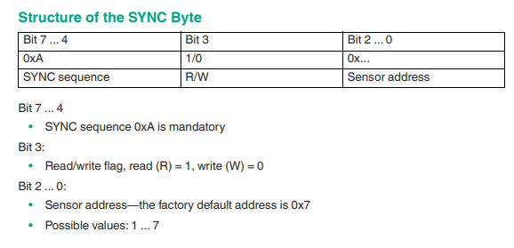

i have sensor with lin protocol which is different from  Standard LIN format
for example   the standard sync byte  is (0x55)
for this sensor it is as below
my question is ,could i change the syn byte in tms570ls1224 to be compatible with the  sensor sync byte .
or is their any way to make the sensor work with my development kit
    I don't think that this sensor doesn't follow the LIN protocol. The SYNC byte you mentioned may not be the SYNC field defined in LIN protocol. Please check with sensor support. It's better to get example code.
    The LIN module on TMS570LS1224 supports LIN2.0 standard. The Master Mode of LIN module is compatible with LIN 2.1 standard.
