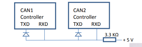

I have implemented a small node of CAN using 1N4148 diodes connected to Tx of both microcontrollers I am sharing the schematic diagram.
I have tried simpler_x.c,simple_tx.c codes from Tivaware peripheral example codes. I am getting output but when I am sending a string to through can bus, can RX object receiving only two characters.
example if I am sending hello then it receiving only "he ". I am doing the project in which I have to sensors values over can bus how to send and receive multiple characters or strings over can bus.
 please guide me, what changes I have to do in the code?

  • This is the schematic of CanNode
      Using diode is only for very short distance, perhaps for a quick start on learning CAN. You need to use a proper transceiver in a real world application. Since you will eventually need to replace the diodes with the transceivers, you should try with the transceivers to see if you can repeat the same problem. If you are seeing the same problem then it is most likely the s/w problem. If with the transceivers, the problem goes away then the diodes will be the suspect. I strongly suggest that you use a CAN analyzer or logic analyzer that can interpret CAN protocol so you know what is going on the bus.  If you try to send 'hello', how will you know if the transmitter is not sending the 3rd character correctly or the receiver is not receiving the 3rd character correctly? Without the CAN analyzer it will be hard to debug. These are the suggestions I can offer at this time. I will close the thread for now. You can always reopen it by posting again if you have new results. Hopefully we will hear from you soon.

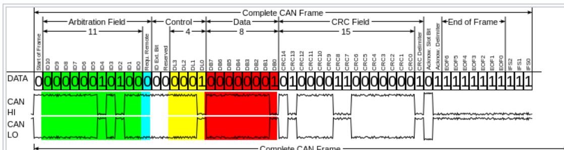

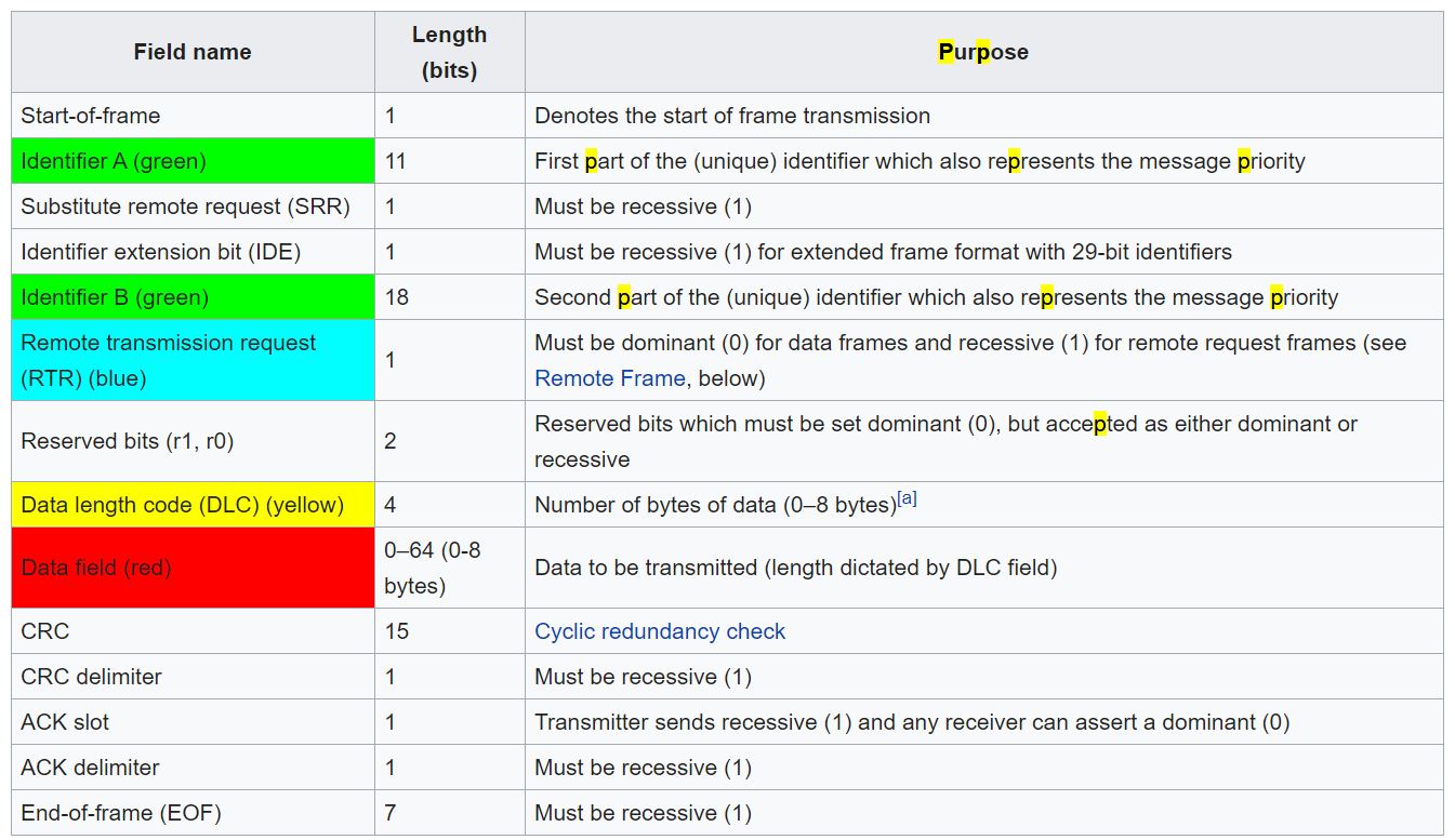

      Do you have updates on the status? I hope you are making progress. Per cb1's suggestion, can you check what message length you are asking the CAN kernel to send out. a CAN frame can have up to 8 bytes of payload. If you have a scope or a logic analyzer you should at least see one CAN frame with the 'hello' as a payload as the 'hello' takes up only 5 bytes.
      Below is an example of what you will expect to see for a 'one' byte payload frame. If you are transmitting 5 bytes you should see the DLC=5. I take the below screenshots from the wikipedia. You can find the same.
