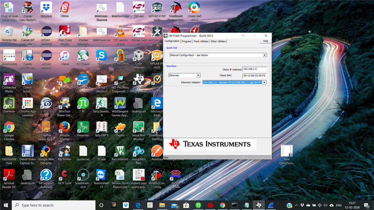

      - Do you have the correct MAC address entered in the LM flash programmer compared to what the MAC address stored in the USER0/USER1 registers?
      - How did you know that 192.168.1.5 is the correct IP for the client? I will suggest you first run a enet_lwip or enet_io example and obtain the IP address displayed on the terminal window. You will then type that IP address into the LM flash programmer. The reason to do that is because running the enet_lwip will lease the DHCP address for some time. During this time you can use that address for your boot_emac_flash example. If you have already done so, then it is fine.

    I cross verified the MAC address with the one in the launchpad printed on backside.

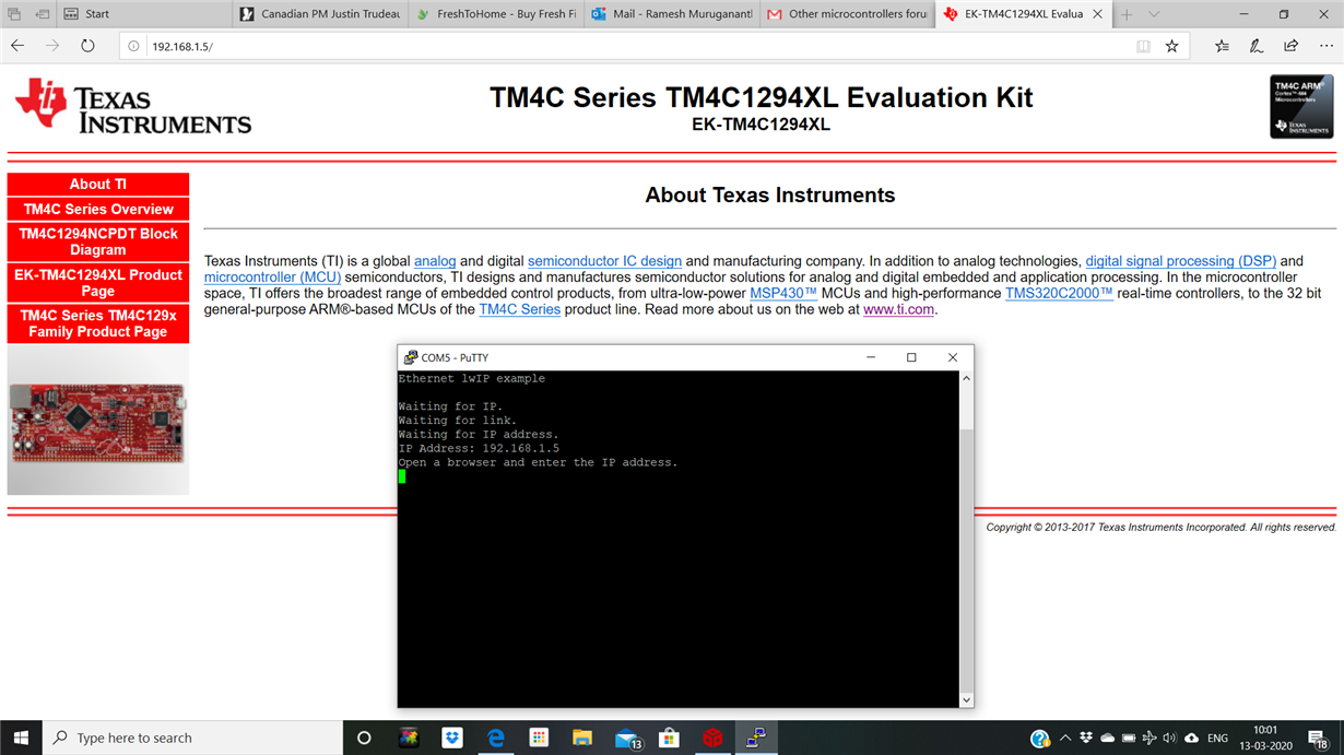

  • I ran enet_lwip.  It works fine.  Screenshot below
  • Hi Ramesh,
      Thanks for providing the enet_lwip result. So it is working. Can you capture the enet_lwip traffic properly using the wireshark? If yes, can you then recapture the result for the boot_emac_flash? When you said there is no BOOTP request from the client, I wonder what is on the traffic? Can you share?

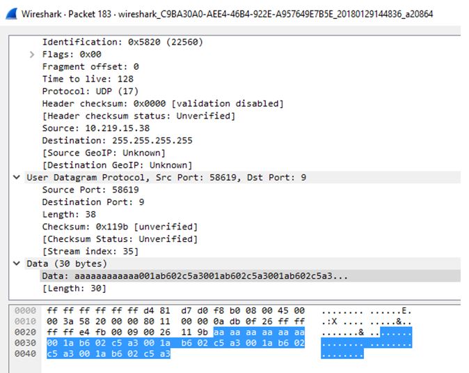

      Once the boot_demo_meac_flash is loaded successfully, the bootloader (boot_emac_flash) will transfer its control to the application (boot_demo_emac_flash). The demo app (the boot_demo_emac_flash.bin program) has code to listen for a magic packet from the TFTP server (the LM flash programmer) indicting that a firmware upgrade is requested and when the packet is received, transfers the control back the boot loader to perform the upgrade. In the LM Flash Program, when you hit the 'Program' button it sends out the magic packet. The magic packet comprises 6 bytes of 0xAA followed by the target MAC address repeated 4 times. When the application receives this magic packet it transfers the control to the bootloader.
      Please look at the wireshark and see if you see the magic packets getting sent out by the PC. You should see something like below. Please note my MAC address is 00-1A-B6-02-C5-A3. Yours will be different from mine.

    However in DHCP case lmflash programmer is sending the magic packet.  But launchpad seems to be not responding back.  screenshot below.
    I also noticed the LED blinking is stopped once the program button is pressed in lmflash,   That indicates the control is transferred to bootloader.  However bootloader seems to be not responding

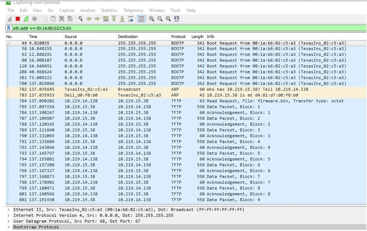

      Immediately, I see the boot_demo_emac_flash.bin getting programmed via the Ethernet port. I use the example as is which is using DHCP. Below is my wireshark capture.

      In the meantime, I rerun the example in the office network and it works every time. The first time I only have the bootloader (the boot_emac_flash) loaded. I hit the Program button in the LM flash programmer and the application (the boot_demo_emac_flash) will be loaded immediately. After the application is loaded the LED on the board starts to blink. This indicates the application was loaded successfully. Each time I hit the 'Program' button in the LM flash programmer again, i will see the application image reloaded.
    https://e2e.ti.com/cfs-file/__key/communityserver-discussions-components-files/908/boot_5F00_emac_5F00_flash.bin
    https://e2e.ti.com/cfs-file/__key/communityserver-discussions-components-files/908/boot_5F00_demo_5F00_emac_5F00_flash.bin
      You mentioned that you could see the LED blinking the first time. Once the magic packet is received it seems to jump back to the bootloader but did not continue to reload the application image. I really don't know what is going on as I cannot reproduce your problem from either my office network or home network. What I'm going to ask you try is to use the bin files I attach here. I'm attaching the boot_emac_flash.bin and boot_demo_emac_flash.bin. Try them and see If you are having the same issue. You also mentioned that even the enet_lwip doesn't work in your office network. Therefore, I tend to think there is some network configuration problem on your office network that you will need to resolve with your company IT experts. I really don't know how to help here.
      When you said the after the magic packet is received the bootloader seems to stuck. Look at the Program Counter and see where it is. Is it stuck in the bootloader or in the application? The application starts at 0x4000. You will need to do some debug on your own.
     Finally, here is the wireshark capture after the magic packet is sent. After the magic packet is received by the MCU, the application image is reloaded again via the TFTP transfer.
