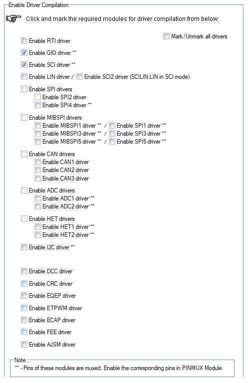

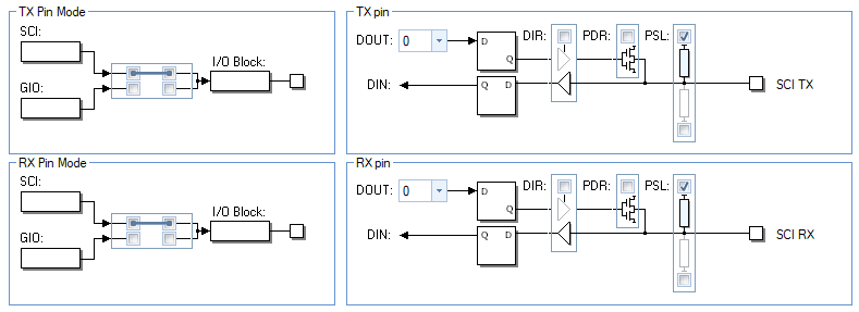

I'm trying to use SCI port to send simple text from uC to PC. I connected J11.33 and J11.34 to my PL2303 converter and then converter to PC via USB.
I used HaloGen to configure the port:
I have the impression that I am bypassing some simple configuration that prevents sending data.
I tried to communicate using SCI / LIN and everything works fine (then I replace sciREG with scilinREG).
I open the virtual port of the PL2303 device for communication. It is configured the same as the port settings in HalcoGen.
In my code I'm using ony sciInit and sciSend:
