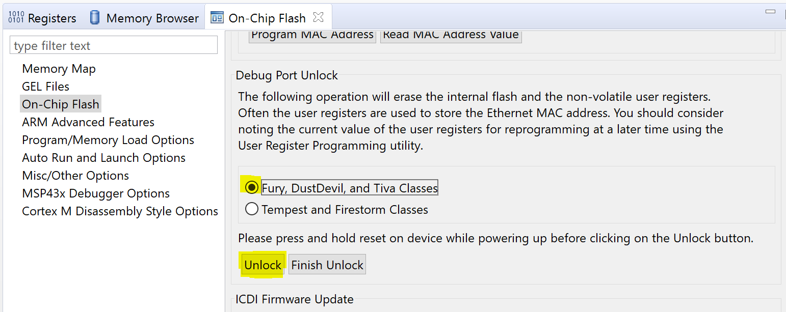

  • Have you tried the steps for recovering a locked microcontroller? Here is a thread that discusses doing that with JLINK.
    https://e2e.ti.com/support/microcontrollers/other/f/908/t/589879?TM4C123BH6ZRB-Question-on-recovering-a-locked-microcontroller

  • I am confused by your comment. The post highlighted as the solution from Chester Gillon in the thread I referenced used a J-Link controller. Perhaps the J-Link Lite probe does not support the scripts. You would need to ask Seggar that question.
    Have you tried using Code Composer and your J-Link Lite probe to unlock the device? I do not have the J-Link lite probe so I cannot verify for you. Here is a picture of using an XDS200:
  • I'll try that solution with the proposed "bitbanged" switch sequence.
    I tried the command on the SWD switch but didn't continue because there wasn't a command for the JTAG part I'll try to run the script.
    How do you get to the On-Chip Flash tab. I checked views on CCS but didn't find it.
    Tuna
  • From the top menu select "Tools" -> "On-Chip Flash".
  • Hello Bob,
    I tried the script, didn't work. I also jumped from ICDI on my ek board, also didn't work.
    I'll just replace the chip because this is proving to be real time sink.
    Also I don't have that option under tools for some reason.
    Tuna
