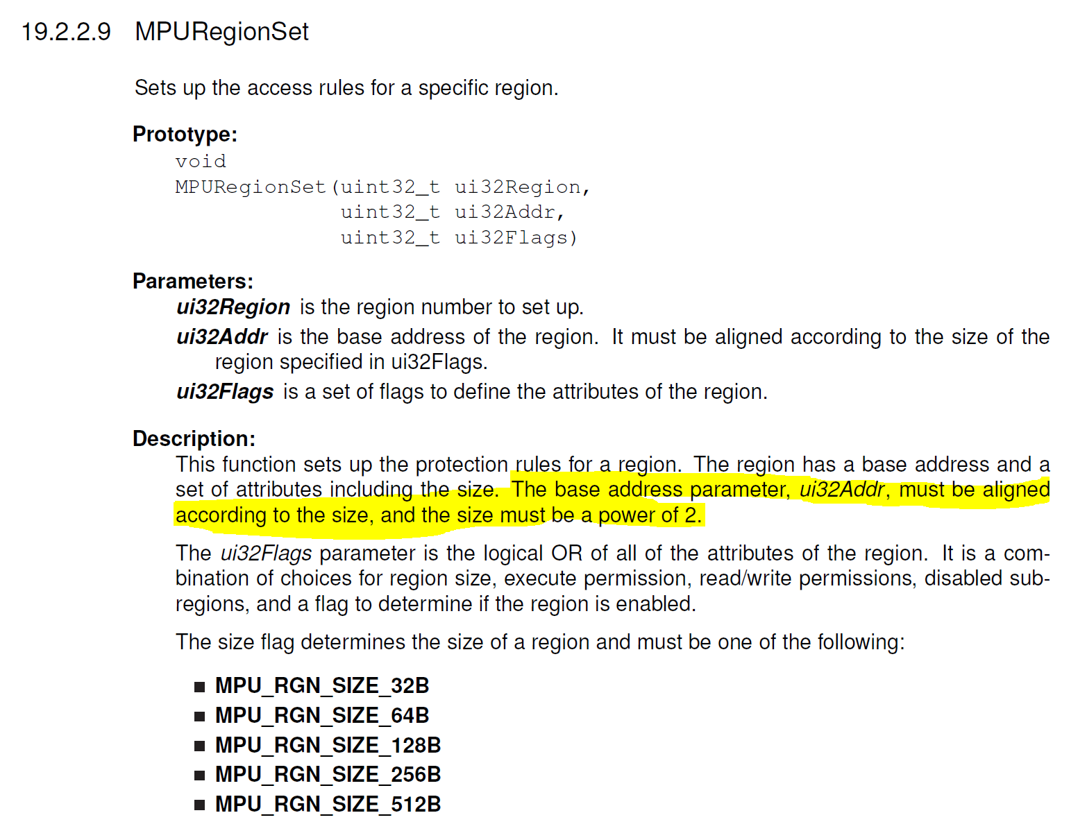

Hi guys,
i am working with microcontroller tm4c129encpdt, and trying to use MPU(memory protection unit), i want to protect 2 parts f ram memory  and 1 part of Flash.
the problem is i do not know what is wrong in my configuration that immediately goes to mpu fault or it crash when i run the project.
i read lots of MPU documentation but coudl not find the answer. the problem happens when in switchfxn(),when i want to change configuration:

  • In both cases, you are not setting the starting address of MPU region 1 aligned to the size of the region. The starting address of a 512 byte region must end in 0x000, 0x200, 0x400 ... 0xE00.
  • ok so it means the blow config is correct???

    actualy i couldnot undrestand exactly how to align them, this is an example in my microcontroller user's guid:

    but the base address is not multyple of the size?????????????
  • Yes, your code now has the region starting address aligned properly. The example in the User's Guide is also properly aligned. The size is 8K bytes. (Note that for computers 1K is 1024, not 1000. It is an even power of 2. 1K is 2^10. 8K is then 8192 (2^13), or in hex 0x2000. Looking at the hex numbers we can see that 0x200008000 is an even multiple of 0x8000. (0x20008000 / 0x2000) = 0x10004. In decimal it is not so clear, but still true: 536903690 / 8192 = 65540
