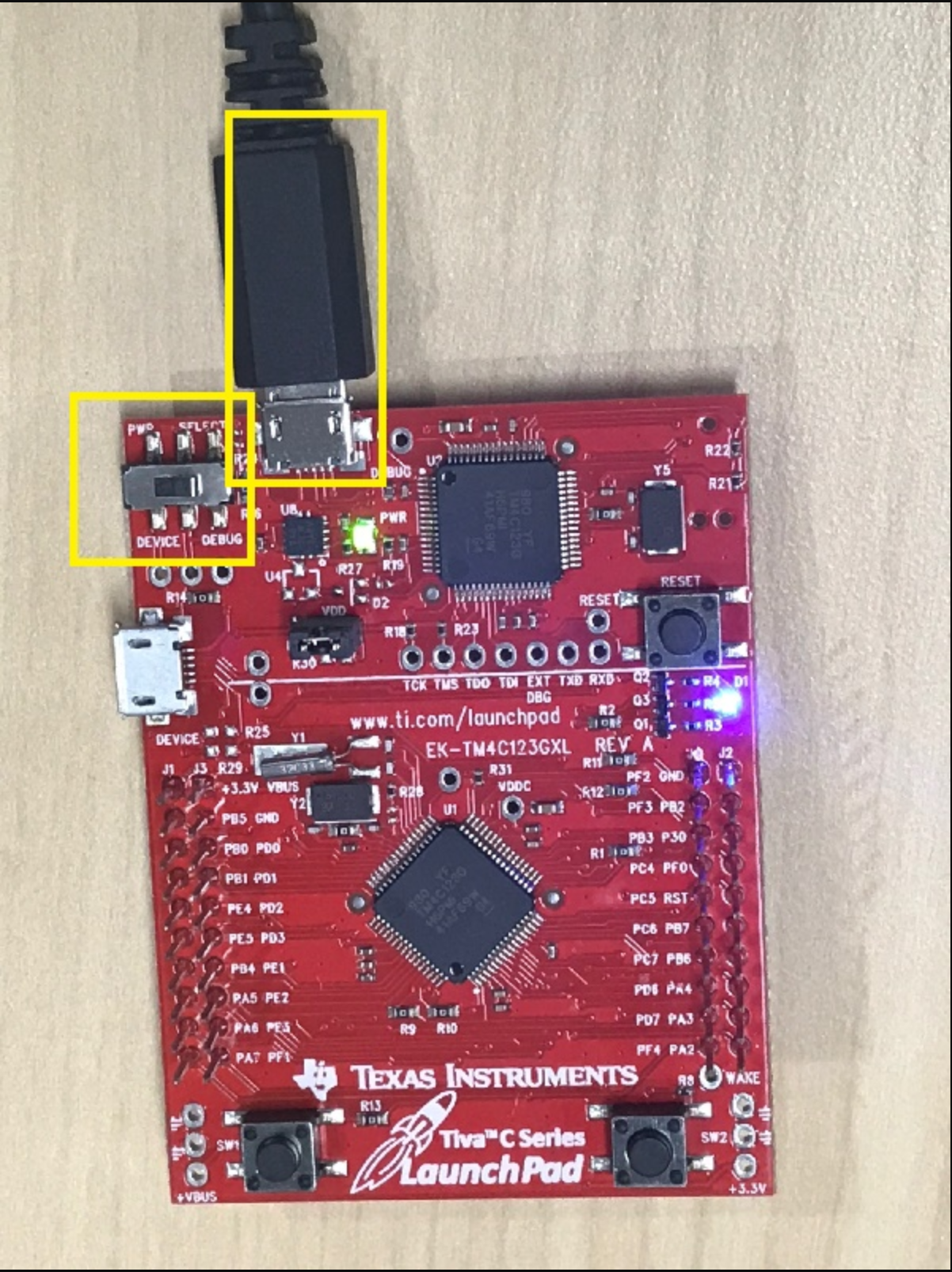

I'm trying to install the drivers for the EK-TM4C123 development kit in Windows 10.  When I plug it into the USB port, it is not visible under "Other Devices" or anywhere else in the device manager.  I've tried on two different Window 10 machines and gotten the same result.  There was no message from Windows 10 indicating there is any issue with the USB port. There is power to the EK-TM4C123 so the USB port at least has power.
  • First, make sure you are connected to the correct USB port.

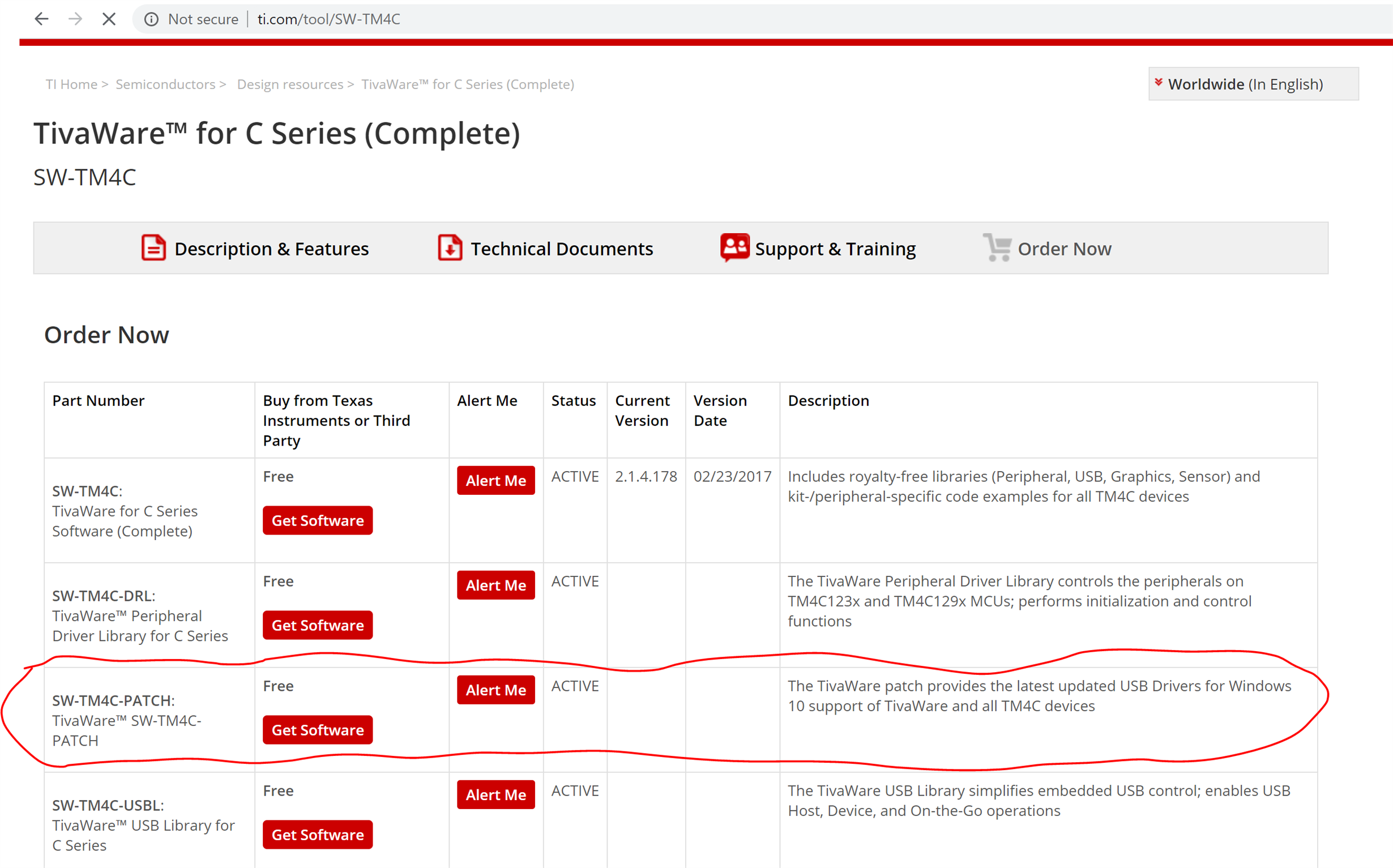

  • Also, did you download the Windows 10 patch files? http://www.ti.com/tool/SW-TM4C
  • It ended up being a bad cable.  When I switched the cable shipped in the box with a different USB cable, the device was recognized by Windows10 and I could install the drivers.
