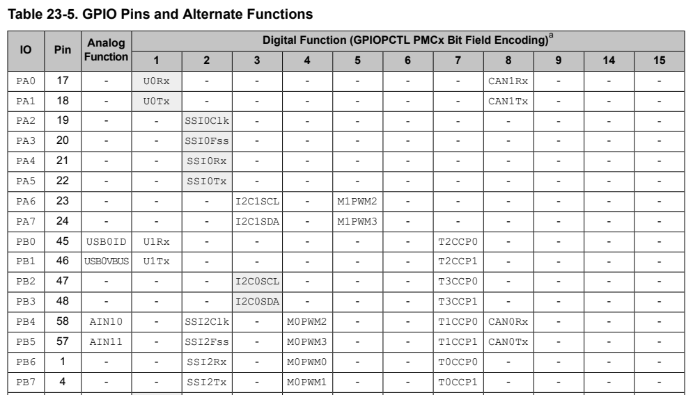

    I can't find GPIO connect to GPTM(General Pulpose Timer Module). There is no inter-conection of  GPIO and GPTM, right ?

    I can't find GPIO connect to GPTM (General Purpose Timer Module). There are no inter-connections of  GPIO and GPTM, right ?
    Wrong - the Timers - as well as the PWM Modules - "share" the GPIO pins.   Your MCU manual describes this as an "Alternate Function" - I include an extract from a simpler TM4C manual - showing this "selection process."
    Note that pins "PB0-PB7 - for this particular MCU - may provide multiple functions."    (Yet only one at a time.)    This holds equally true for the Wide Timers.    Note that your selection of (any) alternate function is greatly eased by your use of the API - rather than (either) "DRM or ASM" code versions.
