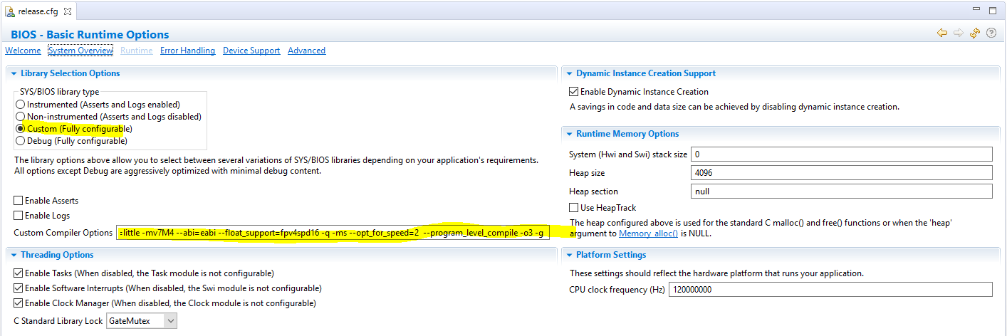

    There are two files at the top of the TI-RTOS for TivaC product: tirtos.mak and tirtos.bld. These are used to build (or rebuild) the product. These types of files are repeated in the items in the products directory. For example NDK.bld and NDK.mak for the NDK, etc.
    The kernel is slightly different though. The SYS/BIOS kernel is generally rebuild when you build the application. The applicatoin can supply different options via the BIOS.customCCOpts string in the .cfg. For example, here are the default options used when using the TI compiler:
