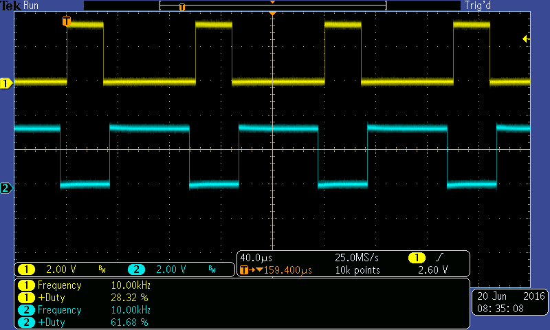

  • "Clever/Thoughtful" better described greetings,    (via young/gifted staff...)
    Might you glance (over/around) your "claim of storm" and ACCEPT:    (CH1: PWM_A,  CH2: PWM_B - Dead-Band enabled via API - w/out issue!)
    Dreaded overlap [your claim] (somehow) appears "Not much in Evidence!"   (As the API's (most proper) assertion of dead-band (both front & back end) assures!)
    I did this for you here 3-4 years back - pity that it must be "re-called" today!   (scope reveals date of capture - 2016!)   Unfortunately the date of your "agreement" remains unknown - might (that) be the sole - and REAL Storm?

    Gl said:
    Other forum folks can now post configure GENS to produce center aligned Non overlapping complementary wave forms.
    What NOW?   Do you mean like (this) - (easily) achieved & presented here (for you) 4 years earlier?     (bottom right of scope cap records date of capture...)
    Are those not overlapping waveforms you picture above? Complementary pairs have a distinctly aligned PWM-A/B edge profile as shown below. Also tested inverted CMP-A/B, UP/DN configurations versus inverting the output of high side drives. And millisecond gap (PWM-A/B drives) also captured via Tektronix scope occurs no matter what, yet with less frequent visits to the blue light lane.

  • Unable and/or Unwilling to "Master the Basics" Greetings,
    No - as (most here) will agree - the scope cap reveals a properly formed, Complementary Pair of PWM Outputs - set w/equal value dead-band - imposed upon (both) leading & trailing edge of PWM_A.   (CH1)
    The time/effort required to provide such a scope-cap for you was in response to your,  "Other forum folks can now post configure GENS to produce center aligned Non overlapping complementary wave forms."
    Both PWM Outputs shown drive an appropriate Gate Driver (positive logic - inputs active high) which in turn provides proper signal level to a pair of "Power N-FETs" - which excite one phase of a BLDC Motor.   And which deliver BLDC Motor Currents approaching 100 Amps - while (never) evidencing deadly, "Overlap" - certain to cause Power-FET "Shoot-Through!"
    For any "overlap" to be noted - both PWM Outputs must be active (i.e. High) at the same time.    Clearly any such (destructive) overlap is "Not at All" visible here.   It is unknown as to "Why you believe (any) overlap has occurred!"    And proves likely to "cast doubt upon" other of your findings & beliefs...
    The context we were speaking of generators CMP-A/B producing non overlapping signals, NOT with dead band enabled. I was unaware you had included dead band in your 2nd capture of the overlap signals discussion, Fig. 23-5.  Adding dead band does not produce overlapping signal pairs, it only delays the generator signal passed into it from PWM-A. I was specifically indicating how overlapping versus non overlapping signals are created and generated, not with dead band.
