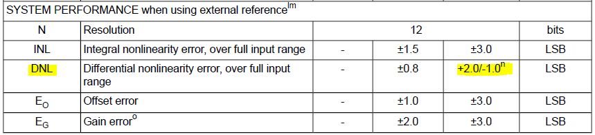

      If you are looking for the differential non-linearity error the it is listed in the datasheet.

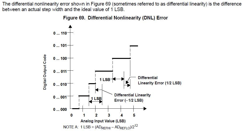

    Although not the same ADC, but a similar 12-bit ADC from a different TI MCU has the below diagram depicting the DNL that might help understanding.
