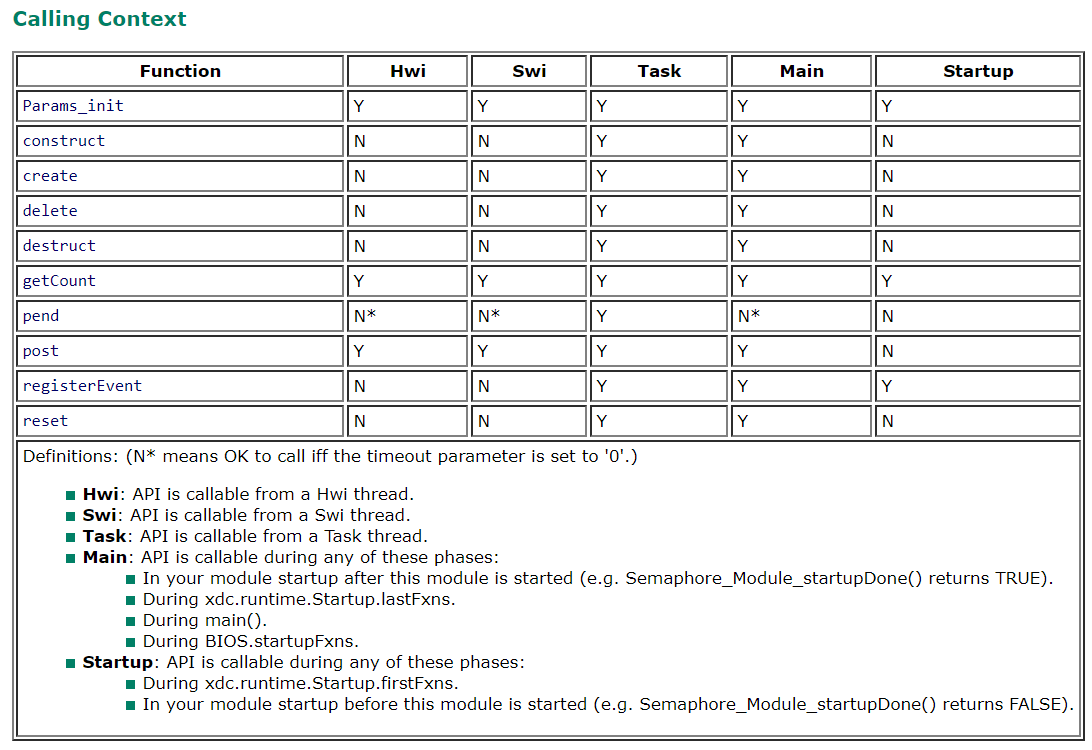

In the context table, I'm correct to classified above as TASK and therefore safe to post semp in timer event function?
I getting missed semp execution every 1mSec because the binary count is 1. How to isolate why the binary count is stuck 1 and does not goes to 0 when it loop back to pend.  Should I use reset before post?

  • Hi Richard,
    Timer functions are ran in the context of a Hwi (not a Task). However, you can call Semaphore_post from any thread type. You cannot call Semaphore_pend from a Hwi or Swi with a non-zero timeout.
    Regarding the missing action. First confirm your timer is running every 1 ms. I expect your task is getting starved out for short periods of time and so the Semaphore_post is being called twice (but staying at 1 since it is a binary semaphore) before the task can run. You can enable kernel logging to see the execution graph. You need to enable kernel logging (BIOS.assertsEnabled = true;) and set up some loggers (var LoggingSetup = xdc.useModule('ti.uia.sysbios.LoggingSetup');) in the .cfg file. You can then pause the target when you think the situation has occurred and open Tools->RTOS Analyzer->Execution Graph.

  • Richard,
    As I stated initially "However, you can call Semaphore_post from any thread type." So Semaphore_post can be called from an Hwi. Please refer to the "Calling Context" section in the API Reference Guide.
