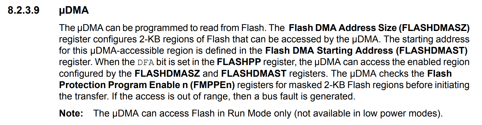

Is it possible to set up a uDMA transfer to move data from flash to CCM (CRC Module)?

The answer is yes. You can find the example project of using uDMA to move data to CRC in <TivaWare_Installation>/examples/boards/dk-tm4c129x/crc32/crc32.c
