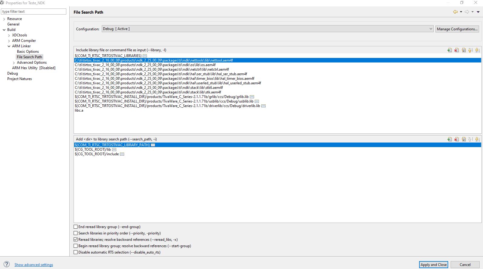

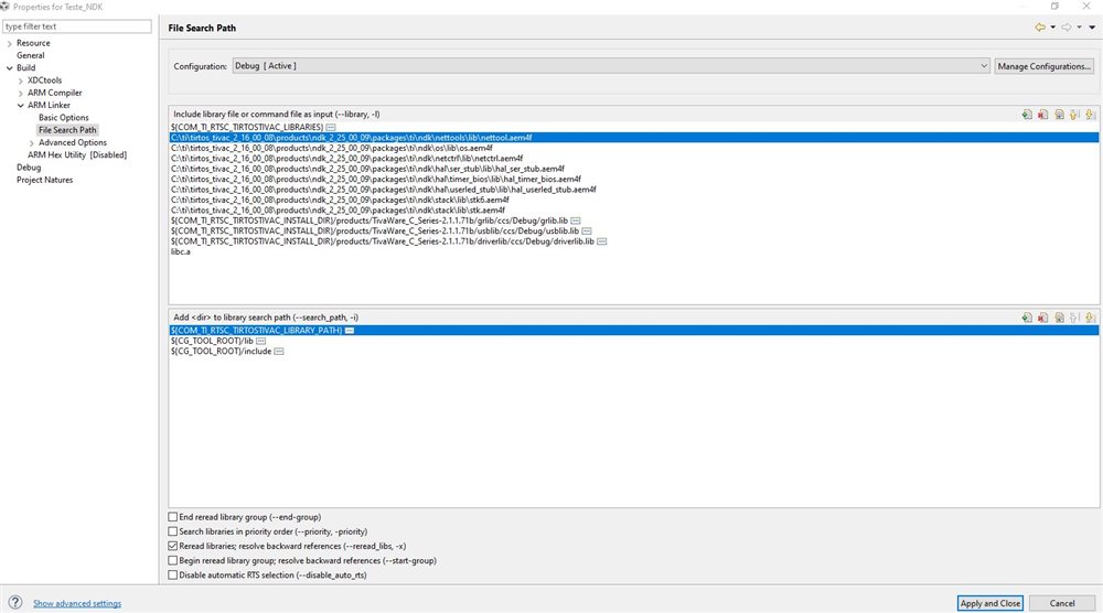

    I forgot to mention that I'm initiating the NDK stack manually via C code. Is necessary to do anything special in the stack initialization process in order to use DNS?
    I'm attaching the stack initialization code below. I have already tested this code and the DHCP is working and I got a successful connection with a TCP server created by me.

  • Hi Dalton,
    Thanks for replying me! These are the libraries that I'm linking:
    Is there any problem with the libraries? I tried to remove the stk6 from the list, but when if I do that I get the error unresolved symbol IPv6Init, first referenced in .../netctrl.aem4f.
    I'm not defining the _INCLUDE_IPv6_CODE in the compiler options, neither in any part of my code.
    About the getaddrinfo(), I didn't know this function. I'm going to read about it now and try to use it.

  • Hello Ronan,
    I see the problem now. You're on the right track with removing the stk6 library but there are a few more things to do. First some background. The NDK libraries are split between ipv4 and ipv6 libraries (ipv6 libraries were built with _INCLUDE_IPv6_CODE defined). It looks like you aren't doing any ipv6 operations, so you should just use the ipv4 versions. Here is what your library list will look like afterwards:
    ti/ndk/hal/timer_bios/lib/hal_timer.aem4f
    ti/ndk/hal/eth_stub/lib/hal_eth_stub.aem4f
    ti/ndk/tools/hdlc/lib/hdlc.aem4f
    ti/ndk/netctrl/lib/netctrl_ipv4.aem4f
    ti/ndk/nettools/lib/nettool_ipv4.aem4f
    ti/ndk/hal/ser_stub/lib/hal_ser_stub.aem4f
    ti/ndk/hal/userled_stub/lib/hal_userled_stub.aem4f
    ti/ndk/stack/lib/stk.aem4f
    ti/ndk/os/lib/os.aem4f
    The libraries in bold are the ones using the ipv4 versions. Your linker error was happening because you only changed the stk library to the IPv4 version (also you only ever need one of the stk libraries included). Now why does any of this matter for DNS operations? Well the HOSTENT struct has the following code in its definition:
    #ifndef _INCLUDE_IPv6_CODE
         * @brief   List of upto NDK_DNS_MAXIPADDR IPv4 addresses (Network format) that map
         * to the given hostname.
         uint32_t h_addr[NDK_DNS_MAXIPADDR];
    #else
         * @brief   List of upto NDK_DNS_MAXIPADDR IPv4/IPv6 addresses that map to given hostname.
         char*   h_addr_list[NDK_DNS_MAXIPADDR];
    #endif
    So using ipv6 libraries in an app that doesn't throw _INCLUDE_IPv6_CODE will cause the wrong address list to be accessed.
    That is most likely the problem you are running into. Try changing your libraries to what I listed above and see if that works for you.
    Dalton
  • Hi Dalton,
    This solved my problem! Thank you so much for helping me!
    The NDK docs don't specify how to link the ndk libraries manually, so I tried to discover by myself based on the unresolved symbols returned by the linker. Now, I'm sure I'm using the correct libraries! :D
