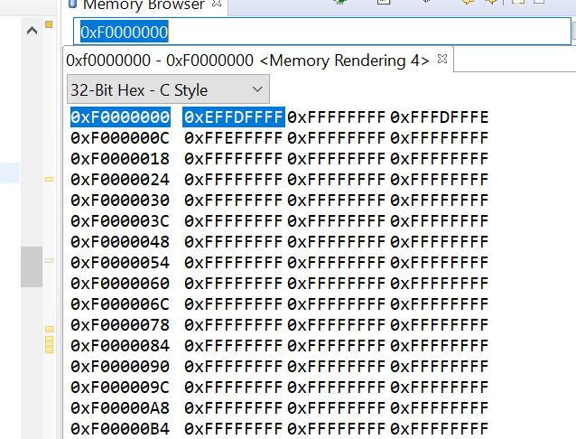

Dear All,
I am trying to write an integer to EEPROM  @ BLOCK_NUMBER = 0x1. But I can not see the writen value on Memory Viewer.
Whay maybe the problem ?
Thanks.

  • Hello Yusuf,
    If you check the memory browser at the end of your main(), you will not see the data because the EEPROM was erased again by calling the function of TI_Fee_Format().
    Please check the memory right after the fee write operation is done.
