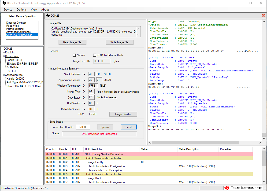

Hi
I use SDK version is simplelink_cc13x2_26x2_sdk_3_30_00_03.
Oad has been used for almost half a year, and there is no problem.
After using many times in a someday, oad always failed.
Attempts to replace the computer, usb transmission line, circuit boards, SDK 3.4 and SDK 3.1 all failed.
thanks.
Best regards
Thank you for having done this test.
I summarize:
- the problem occurs with all the boards
- the problem occurs with the OOB software too
- the problem occurs with different SDK versions
- the problem occurs with different computers
The only element remaining seems to be the way of using OAD. Can you precisely describe the steps you are following?
