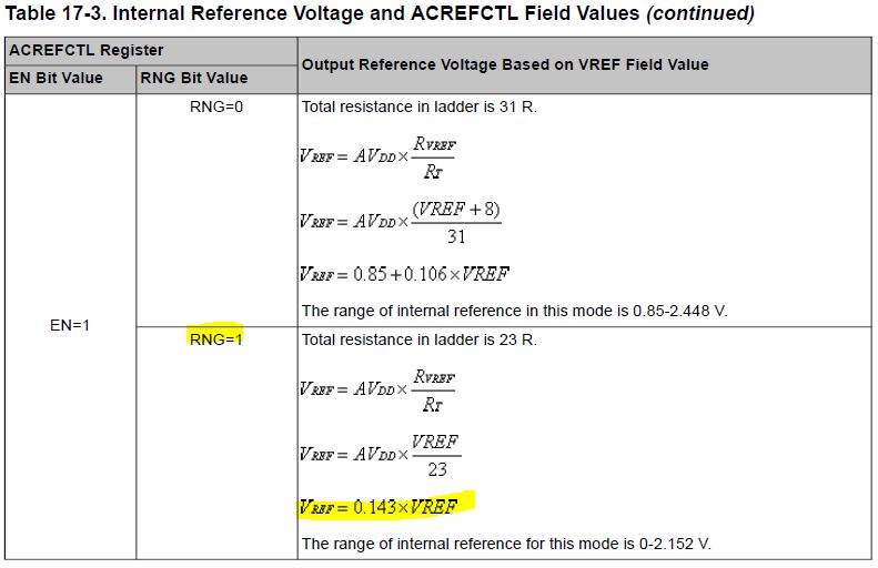

The TivaWare driver library (2.1.4.178) has incorrect and some missing #defines for the analog comparator internal reference setting.
The TivaWare driver library (driverlib/comp.h) internal reference values quoted in the COMP_REF_XXXX #defines do not match the TM4C129E datasheet values in section 25.3.1 and 30.21.
Looking at the StellarisWare driver library,  TivaWare is a copy paste from that for this peripheral
This copy/paste didn't take into account the apparent change in comparator reference hardware as the formulas in the datasheets yield different values (TM4C129E vs LM3S8962).

  • Hi Alexander,
      The TM4C129 has the formula of:
      VIREF (VREF) = VREF * (VDDA/ 22.12 for RNG=1.
      If I pick VREF=15 I should get VIREF=15*(3.3/22.12)=2.238V. This is matching the table shown in the datasheet.
     In the TM4C comp.h for RNG=1 it has the below #define for VREF=15
    #define COMP_REF_2_0625V        0x0000030F  // Internal reference of 2.0625V
     Indeed the #define name is not an accurate reflection of the true reference voltage selection. It should have said #define COMP_REF_2_238V 0x00000030F to be accurate.
      Looking at the LM3S8962 it has the below forumula for RNG=1:
      If I pick VREG=15 I will get 2.145V. This is neither matching the #define. I'm not too sure how the #define names are chosen.
      I will file an internal ticket to track this. In the meantime, please don't mind the #define names but rather the voltage shown in the datasheet for a given VREF and RNG selection.
      Finally, thank you for bringing to our attention of the finding.
