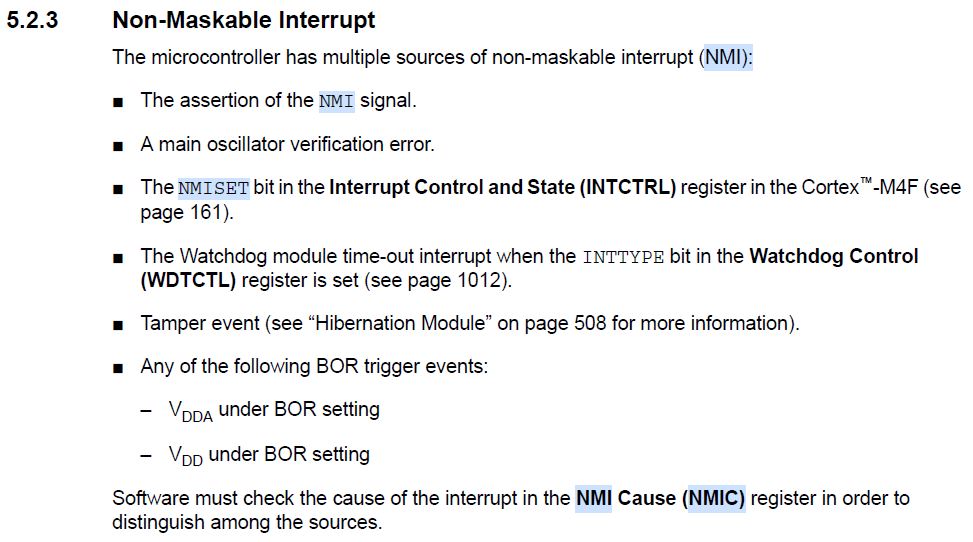

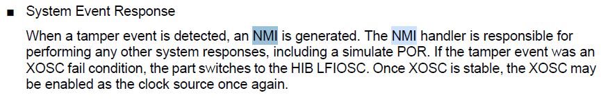

  • My apologies for adding a slightly off-topic question, but:
    Does the Tamper module generate an interrupt on XOSCFAIL?
    There is an interrupt vector for the tamper module, but what kind of interrupt is it (NMI or maskable) and what events are handled here?
    Does the main NMI interrupt vector handle Tamper events as well as the NMI signal? I see the NMIC register has a TAMPER bit to show that the Tamper module was the source of the NMI, but I'm not clear on whether I should add code to my NMI vector handler for Tamper, or if I should add code to the Tamper vector handler for this.
    I suppose it's also possible that the Tamper module provides no interrupt at all for XOSCFAIL, in which case I would need to poll for that. Since the firmware feeds the Watchdog timer periodically, I might just use that function to poll the XOSCFAIL bit and switch the Watchdog over to the fallback clock source when feeding the watchdog.
    Yes, you will need to handle the XOSC NMI in your system NMI handler.
  • Thank you.
    For my edification, what is the purpose of the Tamper interrupt at Vector Number 91, Interrupt Number 75, Vector Address/Offset 0x0000016C ? It doesn't seem that I need it, but I am still curious what sorts of interrupts are handled by that vector.
