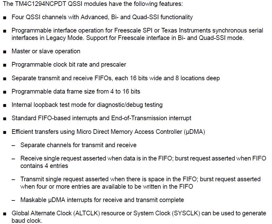

So far I have shortlisted TM4C1294, however It does not seem to have SPI peripheral straight away.
Can you help me to get some insight on this??
