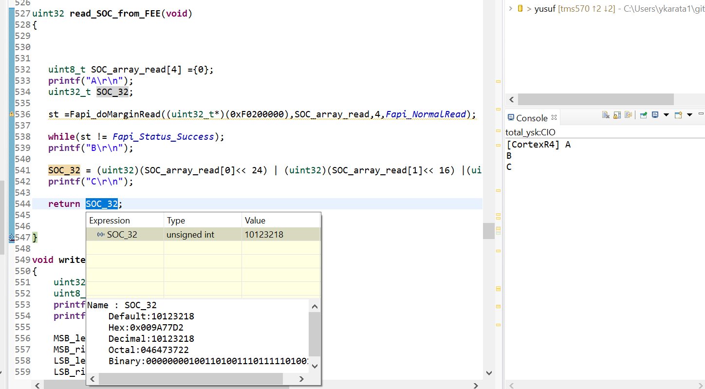

I am trying to read a value that I have written to FEE of TMS570. I have totally a strange error.
My Code Diagram is Like That:
Read_Value_From_FEE(void);
printf("FINISHED\r\n");
As you can see in the figure below, it reads data in the FEE and comes to end of the function and stops since I put a debugger on that. When I press F8 which means proceed it never prints FINISHED and stucks somewhere in there. I could not understand. The situation is same when I remove debugger. It stucks.
Any help will be appreacited.
Thanks.
void main(void)
    uint16 sistem_sayac=0;
    SOC_from_EEPROM = read_SOC_from_FEE();
    Read Margin1 is designed for early detection of marginally erased bits. Please use standard normal read.
    The flash bank7 is used as EEPROM. The HALCoGen generates the FEE drivers for EEPROM erase/program/read. Please use FEE driver for EEPROM operations. Thanks
