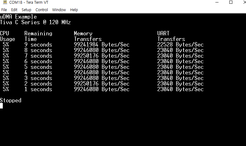

    udma_demo 's output is this
    this messege is printed by UARTprintf();

    I want check 'g_ui8TxBuf' is transmitting in uart
    but 'g_ui8TxBuf' is not printed in UART1 terminal.
    How can I check it?
      Are you using the EK-TM4C1294XL LaunchPad board or your custom board? On the LaunchPad board, only UART0 (default) and UART2 can be connected to the virtual terminal. Please see below excerpt from the LaunchPad user's guide.
    Using the jumpers JP4 and JP5, Controller Area Network (CAN) digital receive and transmit signals can be optionally routed to the BoosterPack 2
    interface. The location of these signals is consistent with the CAN interface on the Tiva C Series TM4C123G LaunchPad and the Stellaris
    LM4F120 LaunchPad. In the default configuration, UART0 is used for the ICDI virtual UART and CAN is not present on the BoosterPack headers.
    In this configuration, the ROM serial bootloader can be used over the ICDI virtual UART. When the jumpers are configured for CAN on the
    BoosterPack, then UART2 must be used for the ICDI virtual UART.
    If you want to use the UART1 then you need to have an external USB to UART adapter such as FT232R. See below links.
    I think the easiest way for you is to change the example to use the UART0 instead of UART1.
