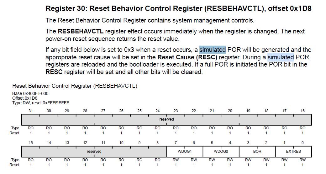

I know that it is possible to perform a software reset using the SysCtlReset() command.
Would it be possible to perform the POR(Power on Reset) on the TM4C1294? As if using the RST pin.
  • Hi Simion,
      You can only generate simulated POR if the reset source comes from nRST pin, Brown-out or Watchdog. You cannot generate simulated POR for software reset.
  • I decided to try to use the watchdog just to trigger the POR, I know it is not a usual way to do this, but look what I did. I set up the following function:
            void POR_RESET(void) {
                ROM_SysCtlPeripheralEnable(SYSCTL_PERIPH_WDOG0);
                ROM_IntEnable(INT_WATCHDOG);
                ROM_WatchdogReloadSet(WATCHDOG0_BASE, g_ui32SysClock);
                ROM_WatchdogResetEnable(WATCHDOG0_BASE);
                ROM_WatchdogEnable(WATCHDOG0_BASE);
                while(1)
                    /* loop */
    and in the handler function, I just left it empty:
    void WatchdogIntHandler(void){
        /* empty */
    It works! My question is, is there a problem with this solution?
    Remembering that I don't use watchdog in my code.
      That is what I would have suggested too, using WD. Please note that the WD will not generate NMI as you configure to generate Reset instead. So the WatchdogIntHandler should never be entered
