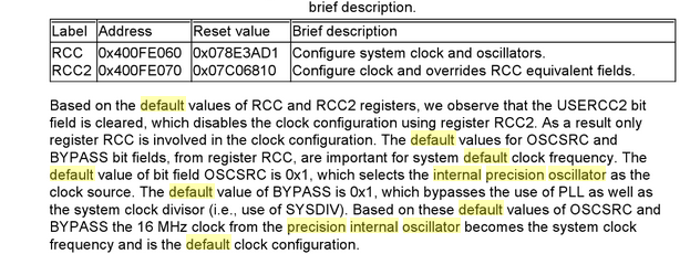

  • Hi Matt,
      Is this your full main()? I don't see you configure the System Clock using SysCtlClockSet(). Please refer to the Tivaware I2C examples under <TivaWare_Installation>/examples/peripherals/i2c. Let me know after you add the SysCtlClockSet(...), does it fix your problem?
  • I'm using the default settings,  so my SysClock is 16MHz( see below). Sorry for the belated update but I think i have found the problem that was causing my address to get NACKd. I am working on fully defining what my assumptions were that led to the issue and defining what the issue was and then I will update the forum once I have fully resolved the issue in order to mark it resolved. Thank you for your suggestion Charles.
  • Hi Matt,
      Let us know your progress on your debug. Other than the System clock which you were correct by default was 16MHz using PIOSC, I don't really spot anything wrong with your code. You also stated you have proper pullup resistors on the SDA and SCL buses. So your hardware seems to be ok too. But to really know what happened and aid your debugging, you really need to have the scope or a logic analyzer.
