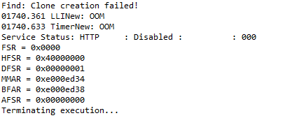

  • Hi Todd
    I try to use ccs debug mode, and occur OOM.
    I think turn ON/OFF DHCP is only a trigger.
    Because run for a while, may occur OOM.
    The console message is below:
    Allen
  • Allen,
    Take a look at the following pages to learn how memory is used in the NDK: https://processors.wiki.ti.com/index.php/TI-RTOS_Networking_Stack_Memory_Usage
    I expect you'll need to increase the dynamic memory manager portion.
    Todd
