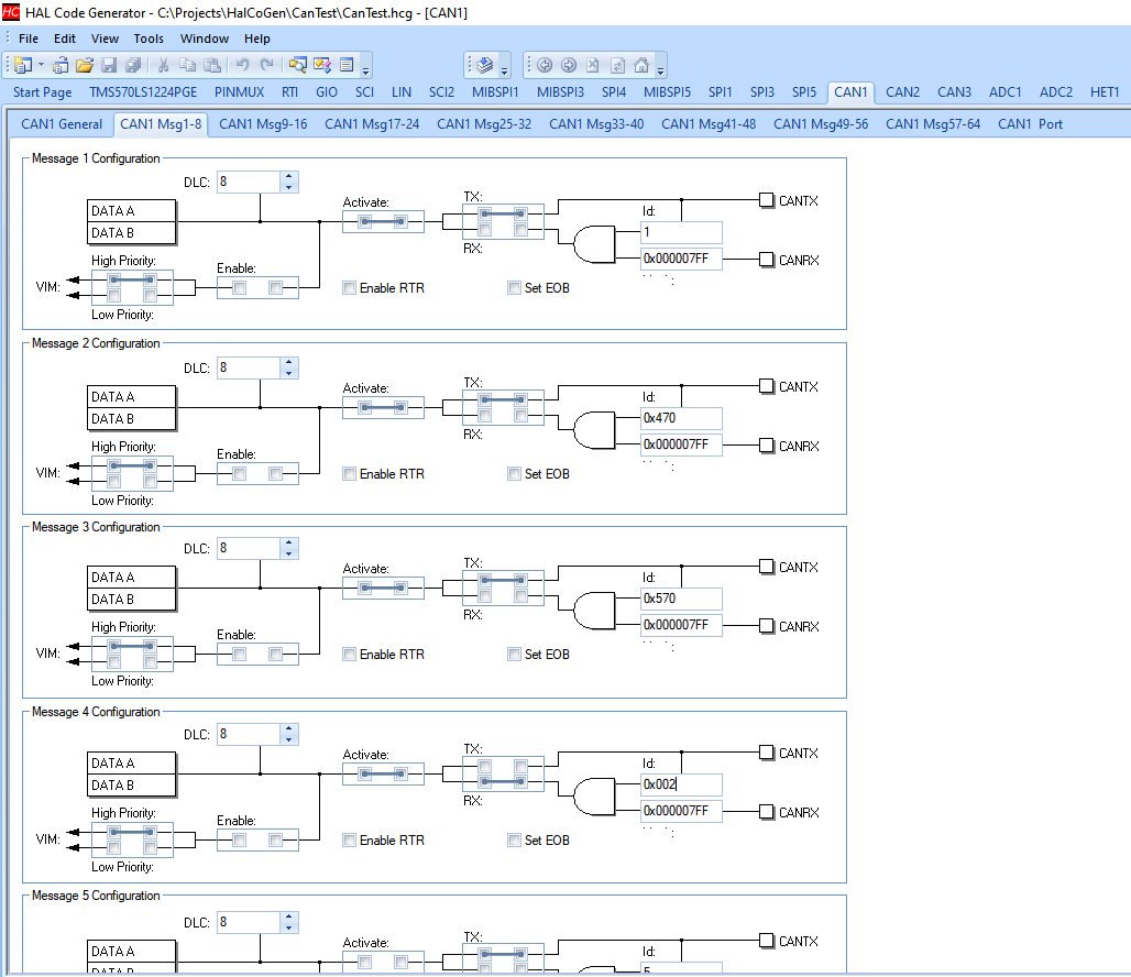

I'm using the Launchpad to try to send and receive CAN messages with the PCan-View software. I am using the ISO1042DWEVM transceiver module. It will send messages from the TX message boxes, but the RX boxes won't receive their messages. Here's the setup in HalCoGen:
I've setup the first four mailboxes in a similar way to the example.
Here's the code I'm using:

My problem is that I can run the program, it will send the messages from message boxes 1,2, and 3, but when I am sending a constant message from PCan-View with message ID 0x2, it is continually stuck in the while loop waiting for an RX message to arrive.
I have been able to get a PSoC microcontroller to receive the message from PCan-View, but the TI processor seems unresponsive to receiving messages. Is there something different I need to change in the initialization of the CAN on the processor or some other code I need to use? I haven't set up the processor to use interrupt based CAN.
