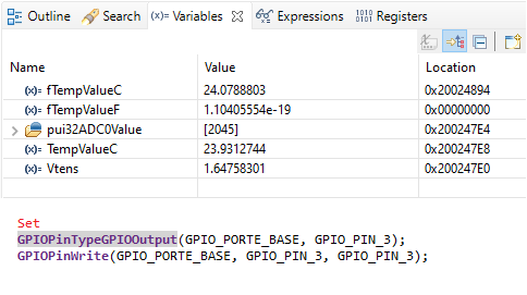

I think there is a bug when reading internal sensor or something missing.
if anyone help, we can fix this.
if i set the GPIO_PORTE_BASE, GPIO_PIN_3  to HIGH before initializing internal temperature sensor, everything is good , reading temperature as expected.
But, if not set, there is a difference reading analog values between set or not set.
You can see the following source code.
How can we fix this ?

  • Hello Selami,
    Use the following for your ADC configuration:
        ADCSequenceStepConfigure(ADC0_BASE, 3, 0, ADC_CTL_TS | ADC_CTL_IE |
        						 ADC_CTL_SHOLD_16 | ADC_CTL_END);
    The reasoning for this is explained on this E2E thread: https://e2e.ti.com/support/microcontrollers/other/f/908/p/775222/2876444#2876444
    The quick summary is: "It does appear that between samples the analog multiplexor switch defaults to channel 0, which means the voltage on pin PE3 can affect the ADC results if the source resistance is too high for the allocated sample time. The source resistance on the temperature sensor is high. Running the ADC at 16MHz and using only a 4 clock sample period, I saw about a 10C difference when PE3 was tied to 3.3V as opposed to GND."
    There are more details about fundamental ADC operation within the thread. Let me know if you have any questions about the discussion that occurred there.
  • Thank you for your response.
    I looked at the discussion.
    i tried the following code :
    ADCSequenceStepConfigure(ADC0_BASE, 3, 0, ADC_CTL_TS |  ADC_CTL_SHOLD_16 | ADC_CTL_END);
    Also tested with SHOLD_64, but there is no result. it is same.
    Also tried : ADCClockConfigSet(ADC0_BASE, ADC_CLOCK_SRC_PLL | ADC_CLOCK_RATE_FULL, ADC_CLOCK_DIVIDER);
    Also tried : for (i=3; i>0; i--) //run 3 loops to meet setling time of temperature sensor internally
    Any configuration i did , There is no result.
  • Hello Selami,
    Using this code I was able to see the correct results regardless of GPIOPinWrite being used to set PE3 high or not:

        GPIOPinTypeGPIOOutput(GPIO_PORTE_BASE, GPIO_PIN_3);
        GPIOPinWrite(GPIO_PORTE_BASE, GPIO_PIN_3, GPIO_PIN_3);
        internal_TemperatureSensorInit();
        while(1)
            internal_TemperatureSensorRead();
  • Dear Jacobi,
    Sorry for late.
    It working now. We fixed this.
    Just, for calibration we edited this part as the following :
    // 65 : calibrated value according to FLIR TG167
    TempValueC = 75 * (2.7 - Vtens) - 65;
    Thank you very much for your valuable reply.
