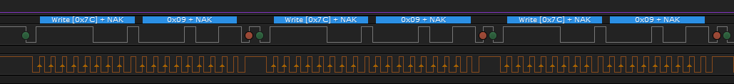

    I ran that code and I was able to see data:
    As long as you have resistors on the pins, you would see the initial command go out on the bus. That capture was taken with no slave device present on the LaunchPad, just the pull-up resistors.
