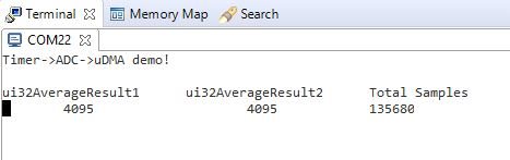

      First of all, with the newly released TivaWare (version 2.2.0.295) there is a new example called adc_udma_pinpong which does the same thing as the the other example uploaded by Bob. By the way, Bob is out of office. I ran the example and below is what I got taking a screenshot of the output. This example uses PE0 as the ADC input. You can change it to your liking. I connect PE0 to 3.3V and I get 4095 as the converted value which is correct.

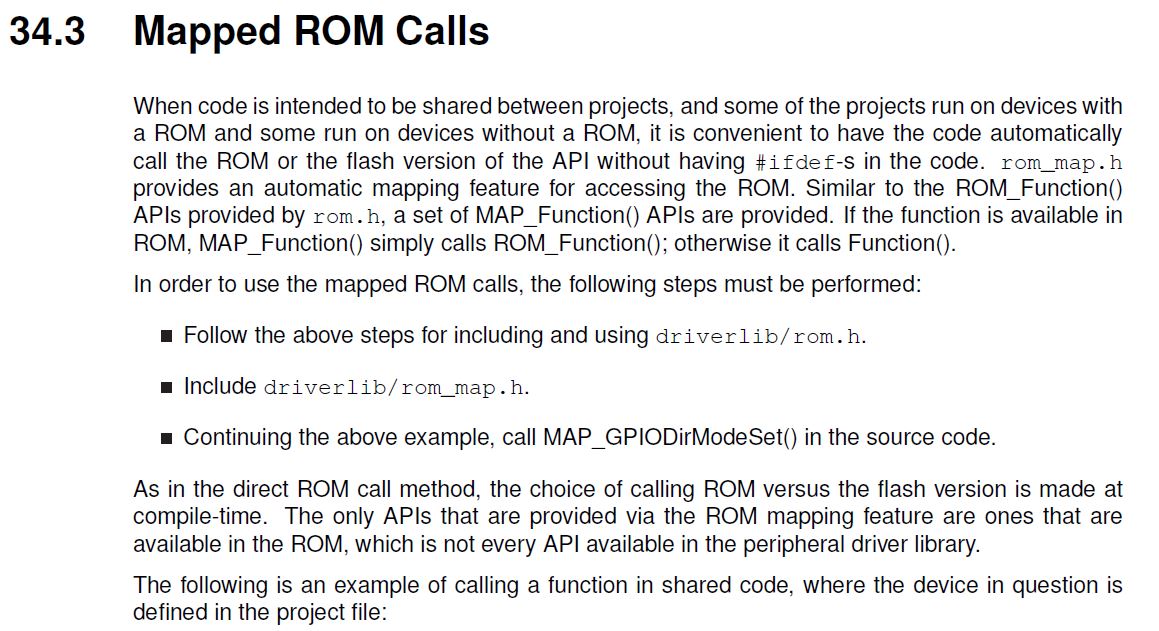

    3) I noticed some functions of driverlib (TivaCSeries)with the prefix MAP_. Why have you done that? Can I remove it?
    Read the rom_map.h file and you will get a better understanding. Basically, if there is function xyz() already available in the ROM then the MAP_xyz() will call the ROM_xyz() or otherwise, call the xyz() instead. Calling the same API/function in the ROM will save you flash spaces and the execution will be a little bit faster. But if you want to debug the code it will be more difficult as there is no symbol. You can change to xyz() while you are debugging your software. Once you are done with your development you can decide if you want to improve the efficiency by changing to MAP_.

    PE2 is correct in Bob's uploaded program. But as I suggested in my last reply, use the TivaWare example adc_udma_pinpong  instead. The one that was uploaded to your original post did not work for me. The average shown on the display is 255 instead of 4095. These two examples are pretty much the same except that the adc_udma_pinpong is included in the latest TivaWare release as an official example.

    4)What is the difference between MAP_function and ROM _function? I knew the benefits of ROM_functions because of the labs that Texas provided, but I have not seen any MAP_functions.
    Did you read the rom_map.h?  Here is one example. If there is already a ROM_ADCProcessorTrigger  API then the MAP_ADCProcessorTrigger just becomes the ROM_ADCProcessorTrigger  or otherwise the MAP_ADCProcessorTrigger is the ADCProcessorTrigger.
    #ifdef ROM_ADCProcessorTrigger
    #define MAP_ADCProcessorTrigger \
    #else
    ADCProcessorTrigger
