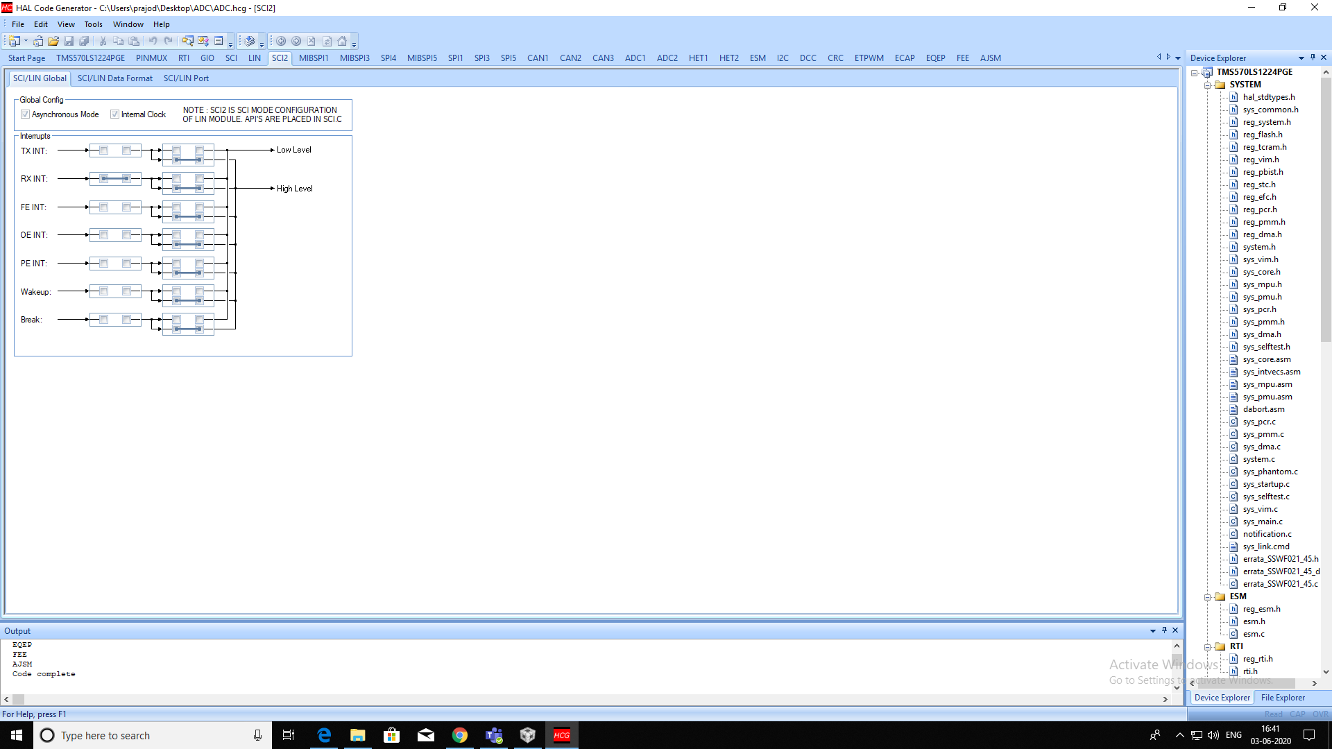

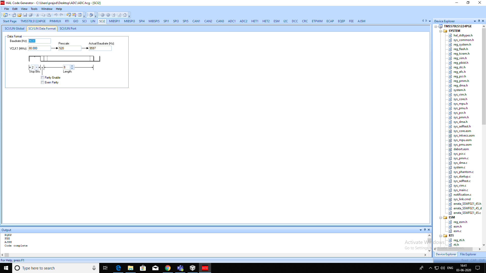

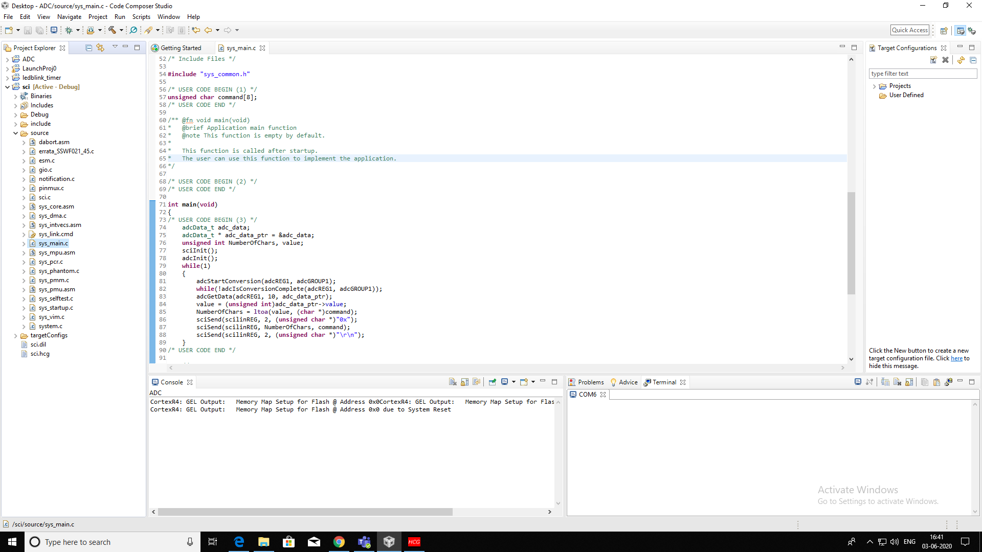

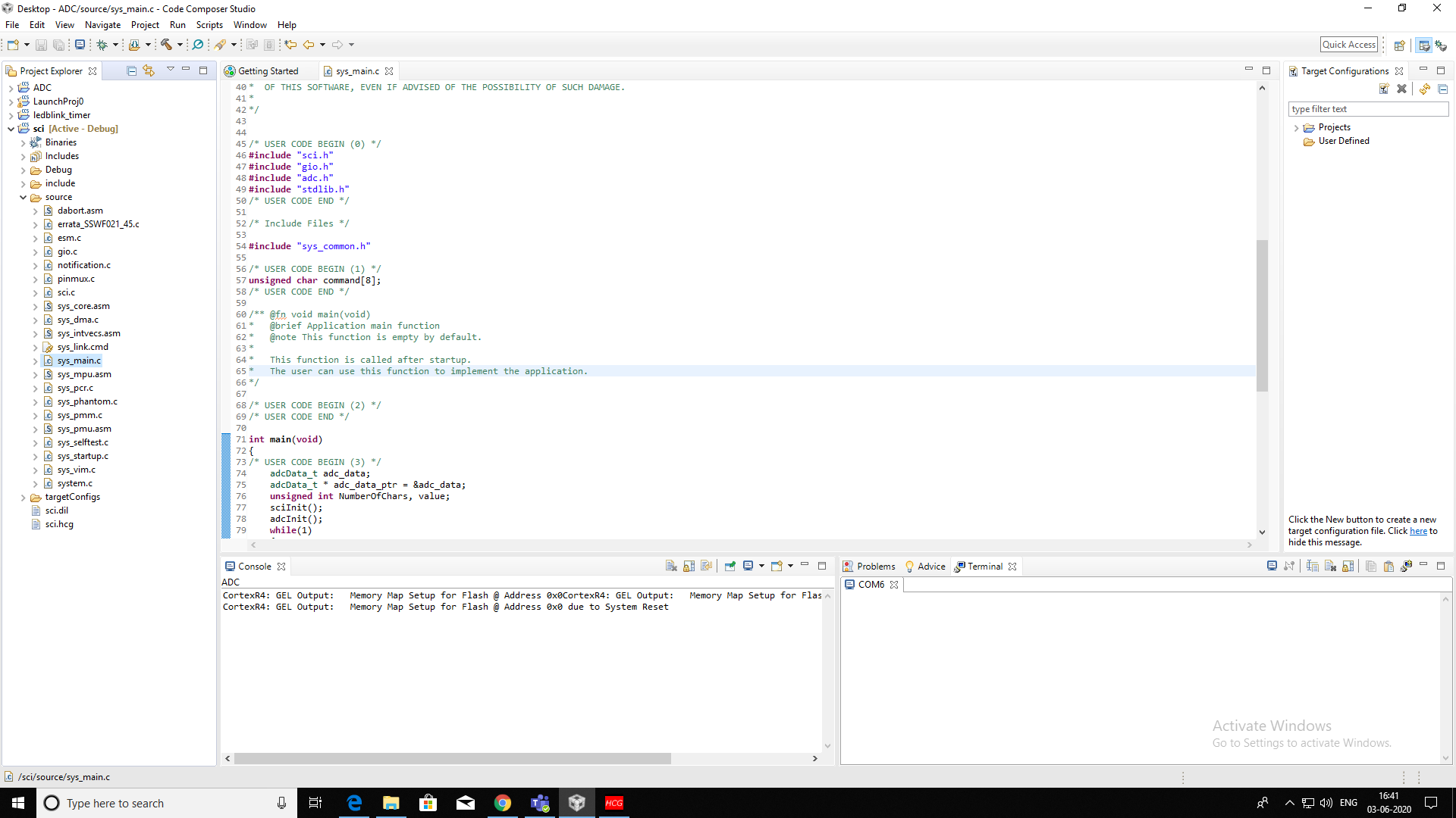

Am trying to get ADC value from inbuilt light sensor to serial terminal.I tried this link https://www.youtube.com/watch?v=YOBWhFE0LZg
But unfortunately am not getting any value at serial terminal. Can you please check my error.Attached the screen shot
    Does the terminal have the same baudrate and stop bit? When you convert value to string, is the returned number of chars correct?
    Please add a breakpoint inside the sciSend(), and check if your data is written to SCI TD register?
    HALCoGen has a very good example to display the ADC values on Terminal.
    HALCoGen-->Help -->Help Topics-->Examples-->Example_adcDisplay.c
