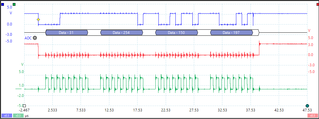

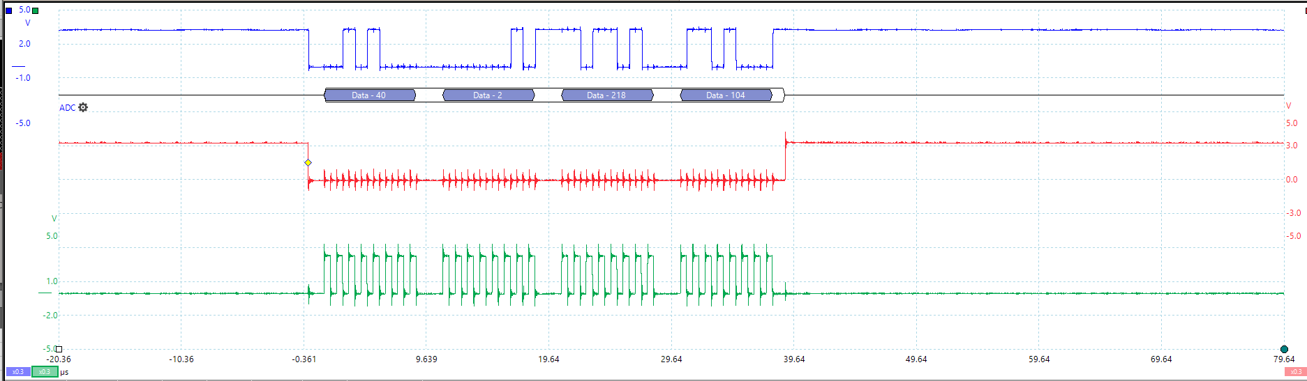

EK-TM4C1294XL: Unreliable SPI Communication
Part Number: EK-TM4C1294XL
I am attempting to use SPI communication to try and obtain ADC readings from an LTC2400. I am having an issue obtaining reliable MISO data from the ADC that remotely matches the protocol decoding on my scope. I am using the LTC2400 with an external SPI clock and am controlling the CS pin manually. Four 8 bit SPI reads are performed and I am comparing the results to that obtained on my oscilloscope.  For instance here are 11 readings:
TI MCU Scope Reading
[0] [1] [2] [3] [0] [1] [2] [3]
2 246 241 40 40 2 218 104 1
3 7 214 40 40 3 11 17 2
3 11 67 40 40 3 3 13 3
3 16 89 40 40 2 249 100 4
3 9 3 40 40 2 252 212 5
2 251 119 40 40 3 4 33 6
3 4 33 40 40 2 251 119 7
2 252 212 40 40 3 9 3 8
2 249 100 40 40 3 16 89 9
3 3 13 40 40 3 11 67 10
3 11 13 11 40 3 7 214
11
A screen shot of the SDO on the blue channel, CS on the red channel, and SCK on the green channel.
I used spi_master.c example in the TIVA documentation. Attached is the code I am using to read the data from the ADC. The function that does the adc reads is called read_adc().
schematic_pg1.pdf
