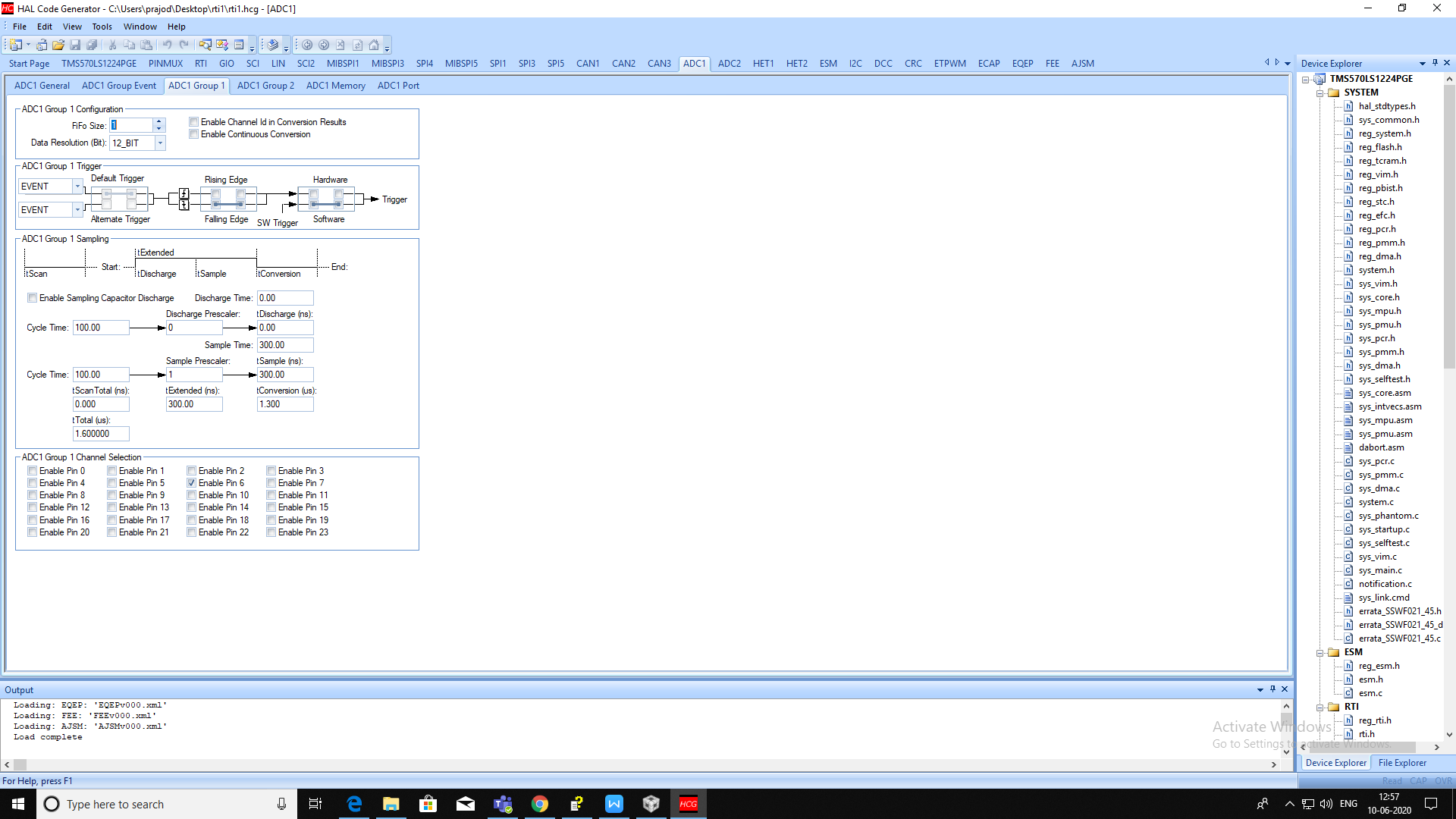

I already done ADC reading by using in built light sensor which is connected with ADC pin number 6. The value is showing in Serial monitor also using SCI.
Now i want to read two ADC at a time. Like, one ADC is inbuilt light sensor and another one is a 5V analog sensor which is connected with Pin 1 in Hal. Below is the my CCS main code for reading inbuilt light sensor using ADC. What changes i should do for adding one more ADC reading. Please help me on this.
