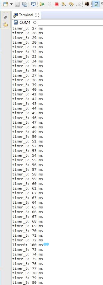

Hello TI,
I am trying to generate 1ms Interrupt frequency with a 16bit Timer, but I am not getting 1ms. Could you please let me know if there is something wrong with my prescaler and Load set?
    TimerConfigure(TIMER5_BASE, TIMER_CFG_SPLIT_PAIR | TIMER_CFG_B_PERIODIC );
    TimerPrescaleSet(TIMER5_BASE, TIMER_B, 240);
    TimerLoadSet(TIMER5_BASE, TIMER_B, 500);
and is there any possible way to check if the timer is configured correctly?
Thanks alot for you support!

  • Those values worked for me. Did you configure the system clock for 120 MHz? What rate are you getting?
  • Hello Bob,
    thats right, my system clock is running on 120MHz.
    The thing is that I am running Timer 0 and Timer 5 parallel each with the different interrupt frequency.
    Timer 0 with 1ms and Timer 5 with 100ms. But they seem to be not synchronized.
    My method of counting: In both ISR´s I am incrementing (Timer0+=100 ms and TimerB++) a variable`s value each time the timers overflows and print their values.

  • What baud rate are you printing at? At 115200 baud it will take 1.3 mS to print the 15 characters represented by your string.  I suspect you are missing some of your 1mS interrupts because of the time needed to output to the UART.

    Well, I am running on a baud rate of 15200 thats right.
    That's a plausible explanation. Thanks!
    Do you have any other idea how the problem could be solved or the time could be measured with the help of timers?
    Br,
    Ali Reza Noori
  • Several solutions. Print fewer characters. Use a faster baud rate. Only increment the counter in the interrupt routine and set a volatile flag. In the main loop, poll for the flag and then print only the even count values.
    Honestly, using a counter to verify a counter is not a good idea when they are running off of the same time base. Toggling a pin and using a digital scope or logic analyzer will give a better indication that the timer routines are correct.
