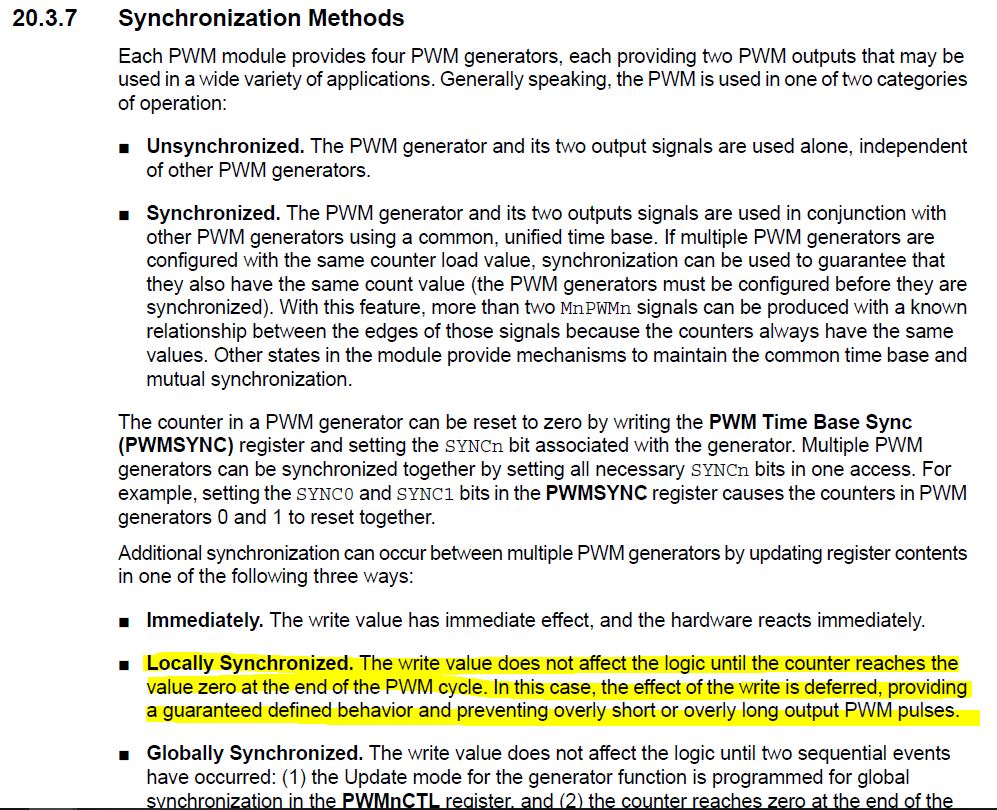

      If you want to configure duty cycle you will use PWMPulseWidthSet(). If you want to configure the period you will use PWMGenPeriodSet().
      The below would be an example to configure the PWM module. You would want to use PWM_GEN_MODE_GEN_SYNC_LOCAL so that if you want to change the duty cycle or the period repeatedly, the change will take effect at the end of the PWM cycle.

      Where did you get this example? I don't think this is a TivaWare example. In any case, if you want to change the duty cycle in a 2-second interval then it is best that you add a timer function into your application. The timer will be configured to timeout every 2 seconds. In the timeout ISR, you can change the duty accordingly (e.g. 110 or 60).
