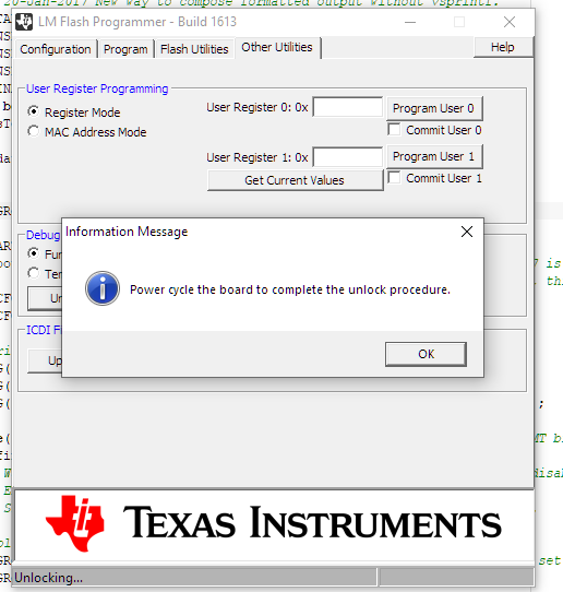

I misprogrammed BOOTCFG with a value FFFF3EFE which does not match the pin I'm using on my board. I'm using the flash commands mentioned in other posts. Since NW is 1, I assumed that I could still reprogram it with my new desired value of FFFF92FE. However, every time I reboot it reverts back to the old value.
This made me think I needed to erase the flash first

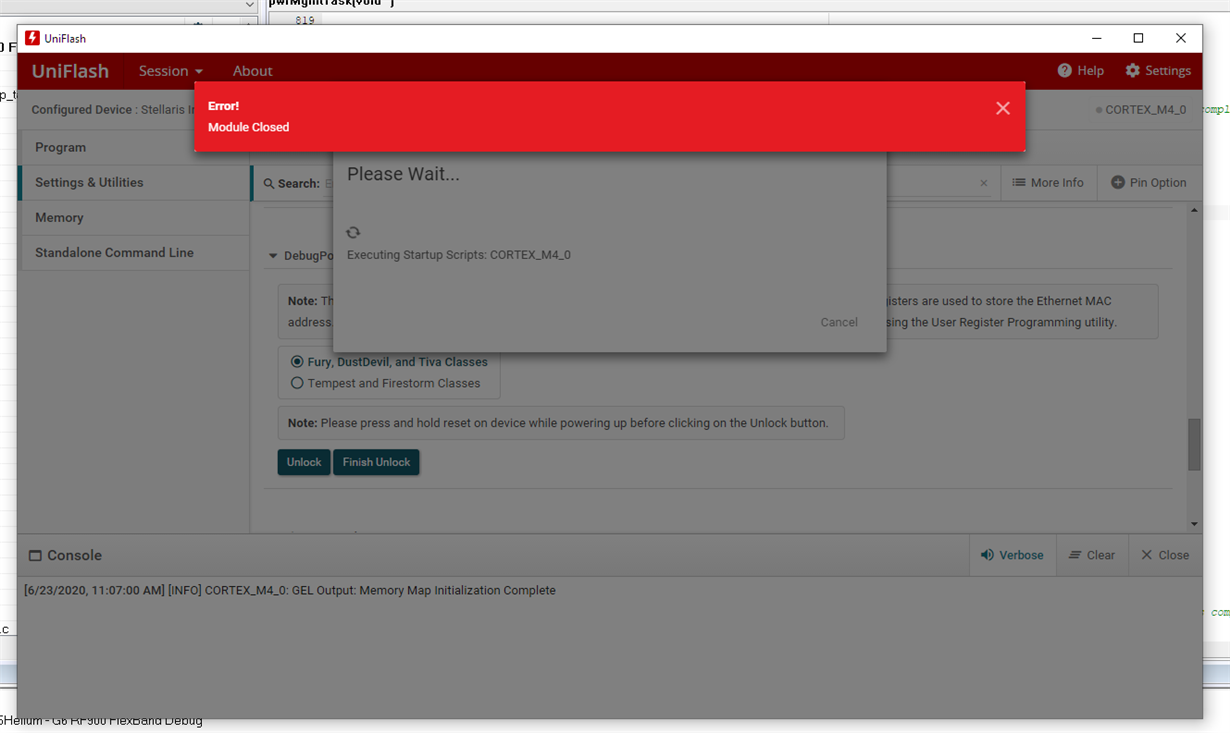

I completed the Debug Port Unlock sequence using LM Flash Programmer with the Fury, DustDevil, TM4C123, and TM4C129 Classes selected. I used the Stellaris ICDI board for this procedure. I have been able to complete the unlock a few times using the sequence described by the dialogs. However, every time I reboot the TM4C129 the BOOTCFG still retains the old value.
Am I on the right track here, and what am I doing wrong? Is it possible for me to rewrite BOOTCFG on TM4C1290NCPDT ?
