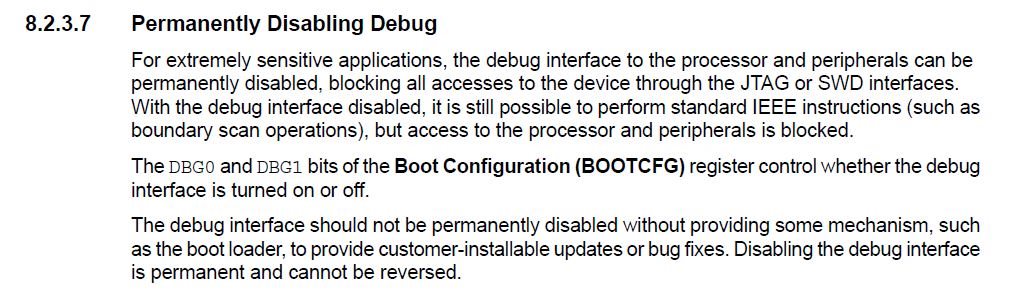

I would like to protect the programmed code in the flash memory after programming.
(Prevent the program in Flash from being read after programming)
Is the above setting possible with Uniflash?
If yes, could you tell me the procedure?
If no, could you tell me how to protect programmed code in the flash memory after programming using other TI tools?
