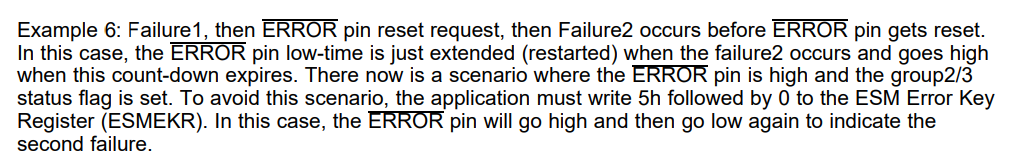

I saw 12.2.2 ERROR Pin Timing in the following document
https://www.ti.com/lit/ug/spnu515c/spnu515c.pdf
I feel confusion with Example 6. Could anyone show me a Figure  like Figure 12-8. ERROR Pin Timing - Example 5?
If there are more than two failures, how should the application handle these failures?
what is the expected phenomenon of nERROR Pin?
