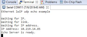

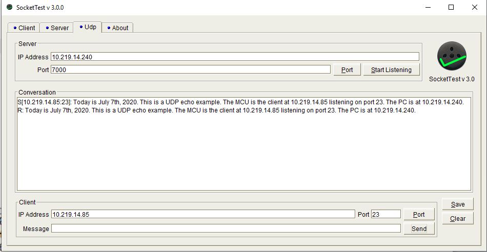

I wanted to transmit data to the udp_client using the udp_sendto function. The UARTprintf function prints the Send OK, but the data never reaches the client, as well as the echo of the client works fine. The data from the server side is not displayed over the client side.

    UARTprintf("Calixto lwIP udp echo example\n\n");

    //Run the udpSendReceive Linux or Windows executable that is shipped with TI-RTOS.
    //The executable is found in:
      //<tirtos_install_dir>\packages\examples\tools\udpSendReceive
      //Usage: ./udpSendReceive <IP-addr> <port> <id> -l[length] -s[sleep in uS]
      //<IP-addr> is the IP address
      //<port>    is the UDP port being listened to (23)
      //<id>      is a unique id for the executable. Printed out when 1000 packets are
      //          transmitted. It allows the user to run multiple instances
      //          of udpSendReceive.
      //Optional:
      //  -l[length]      size of the packet in bytes. Default is 1024 bytes.
      //  -s[sleep in uS] usleep time to between sends. Default is 1000 uSecs.
      //Example:
      //      udpSendReceive 192.168.1.5 23 1 -s100
    //Messages such as the following will begin to appear on the terminal window when
    //a UDP packet has been echoed back:
    //        Starting test with a 1000 uSec delay between transmits
    //        [id 1] count = 1000, time = 12
    //        [id 1] count = 2000, time = 24
    //        [id 1] count = 3000, time = 36
    udp_echo_init();

     I just ran the example and it works for me. See below captures.
     When you first run it, you will see IP address acquired for the client (the MCU). My displays 10.219.14.85. Yours will be different which is dependent on your DHCP server.
    Next I bring up a tool called SocketTest. This is a Windows application running on the server (the PC). I type in my PC's IP address which is 10.219.14.240. Again, it will be different for you. You will need to run a ipconfig on your PC to find out what your PC IP address is. I also type in my client's IP address (10.219.14.85) from port 23. As you can see the message that is sent from the PC is echoed back by the client.
    This is the example project I run. It should be the same as the other post.
